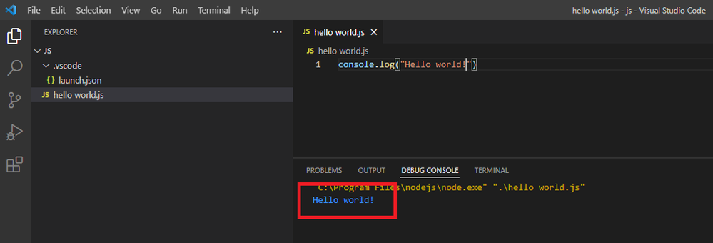

Unlike Python, it doesn't seem like you can just  type some JS like  console.log('Hello World');  and then run the code to output some text.
I tried searching the web and I got a bunch of results about node.js -- which I have installed. Unfortunately, I still can't figure out how run a basic script, such as print "Hello World".

With node.js installed, in VS Code either open the folder containing your .js file (File -> Open Folder...) or open your .js file directly (File -> Open File...)
  • with the folder open - click Run->Add Configuration... pick node.js, close the launch.json file then select your .js script in the sidebar to open it in the editor and Ctrl-F5 (or Run -> Run Without Debugging) to run.
  • with the file open, Ctrl-F5 to run, pick node.js.
The advantage of opening the folder rather than the file is that you save your run config and don't have to set it up every time.

Yes! That worked!
I used the folder option you mentioned.
