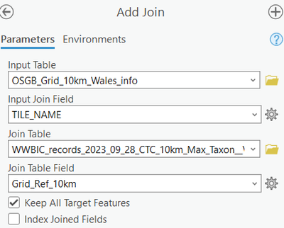

I am trying to join a table to a feature class using the Add Join tool. The box 'Keep All Target Features' is ticked:
Based on my previous experience, and the info on the pop-up box of that parameter, this should mean that all features in the input layer are kept, regardless of whether the join fields match. However, the resulting output is only including input features that match on the join table field, regardless of whether the box is ticked. Basically it seems stuck on performing an inner join even though an outer join is selected. This happens regardless of whether or not the fields are indexed. Both the feature class and the table are stored in a geodatabase.
Please can anyone advise as to why this might be happening?

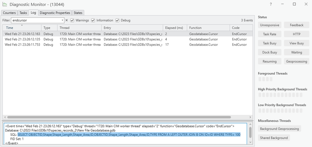

If we look at the Diagnostic Monitor tool, we can see that ArcGIS Pro has sent this SQL query to the database (the SQL formatting is mine):
SELECT
    OBJECTID,
    Shape,
    Shape_Length,
    Shape_Area,
    ID,
    OBJECTID,
    Shape_Length,
    Shape_Area,
    ID,
    TYPE
FROM
    A
LEFT OUTER JOIN
    B
    ON ID=ID
WHERE
    TYPE= 100
That WHERE clause applies to the entire query.

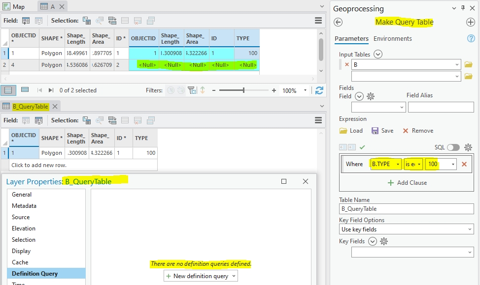

  4. Make Query Table, since it doesn't put its SQL expression in a definition query, it hides the SQL expression, unlike Make Table View and Make Feature Layer.
    1. See the list of options in this post: Consistent/visible SQL expressions and query definitions in layers
Here's the result when using Make Query Table to pre-filter B before joining. It seems to work:
The downside is that the SQL expression is hidden. As far as I can tell, it is only visible via code, such as saving the layer as a .LYRX and then viewing the JSON in a text editor. So, users would have no way of knowing that the table is being pared down. The best we can do is put something in the layer name, such as "B_QueryTable_Filtered".
