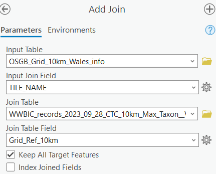

I am trying to join a table to a feature class using the Add Join tool. The box 'Keep All Target Features' is ticked:
Based on my previous experience, and the info on the pop-up box of that parameter, this should mean that all features in the input layer are kept, regardless of whether the join fields match. However, the resulting output is only including input features that match on the join table field, regardless of whether the box is ticked. Basically it seems stuck on performing an inner join even though an outer join is selected. This happens regardless of whether or not the fields are indexed. Both the feature class and the table are stored in a geodatabase.

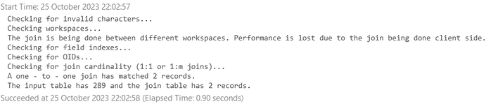

This is the output from the Validate
I'm not sure what extra that tells me, as I already knew there were only 2 matches, but I want to retain all the rows that don't match.

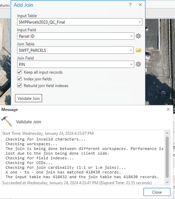

I have encountered this issue as well when joining a table to a layer both from file GDBs in Pro 3.2. The validate shows that there are 2 records that are not joining, but because not all the input records are being retained despite the check box being checked, I cannot see which two records out of 400,000+ are not in both layers.
After completing the join, you can see there are only 418,430 records in the join table
Please get this fixed ☹️
