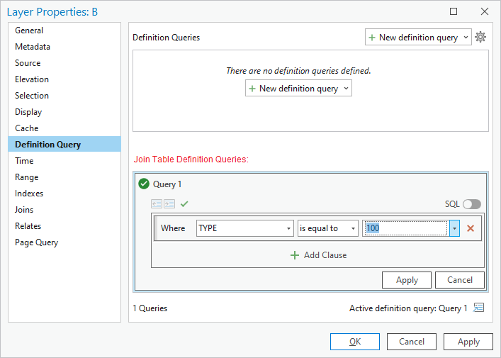

When joining to a table that has a definition query, the definition query gets applied to the input table (and to the join table). The definition query effectively becomes an inner join, even if "Keep all input records" was checked in the join.
That ends up being a gotcha in a lot of cases.
Users would expect the definition query to be applied as a "pre-filter" to the join table only, instead of applying the definition query to the resulting joined tables.
Could that behaviour be changed so that the definition query on the join table remains independent (as a pre-filter)?
Maybe something like this:
