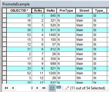

In this simplified example I would select say all the houses on Main street in a two block area
The result would look something like this, showing highlighted records in a random order in the table.

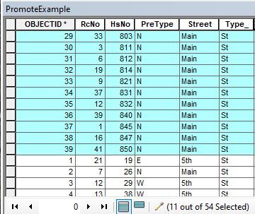

Say I sorted on address then selected Promote.  Promote would then move all the selected to the top of the table, and the unselected still showing but listed below the selected.  Each group would be sorted by HsNo in this case. I could then scroll through the table (entire table) and look for anomalies in my selection.  This was a very useful tool in AV3

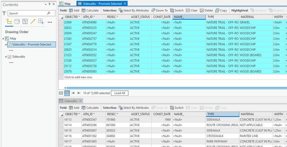

For what it's worth, I tried mocking up something similar in Pro, just to see what it might look like.
I added the FC twice to the map:
  1. The first feature layer's attribute table acts as fake "promote selected records" functionality. Select records; show selected records only.
  2. The second feature layer is the full attribute table. All rows shown.
It was pretty cumbersome to use in practice. True "Promote Selected Records" functionality is still needed.
