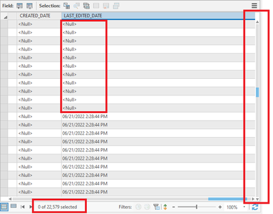

When sorting a field in the attribute table, it would be helpful if we could specify how nulls are handled (NULLS FIRST vs. NULLS LAST).
For example (Oracle), I want to sort a date field descending so that the latest dates are at the top. But when I do that, 1) nulls are at the top, then 2) the latest dates are shown next, then 3) the first dates.
That's a nuisance when dealing with large tables. I need to painstakingly scroll down through nulls to get to the first instance of a non-null date in the list. (In my case, I had to scroll through 10,000 nulls...and then look for where the nulls stop and the dates start)
Sorting in ascending order doesn't help either.
It would be better if I could specify that I want the nulls to be last in the list, even though I'm sorting descending.

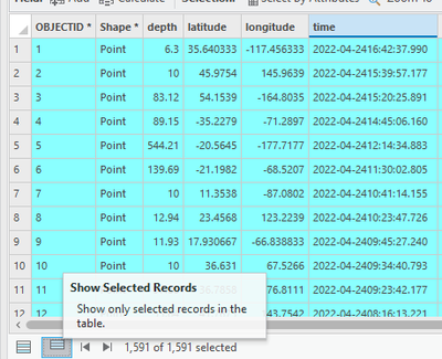

You could select features where the date is not null, then switch to Show Selected Records and sort on the date field there:
