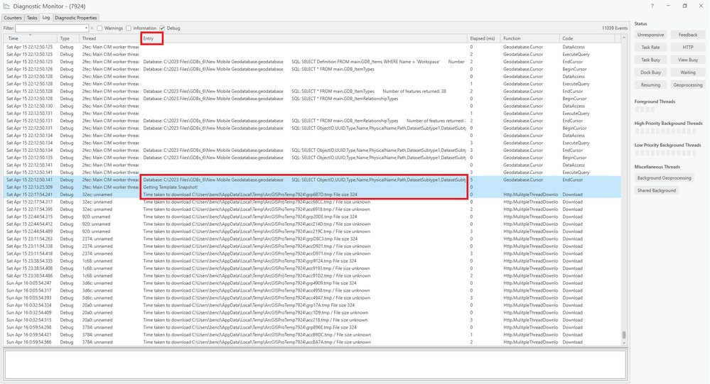

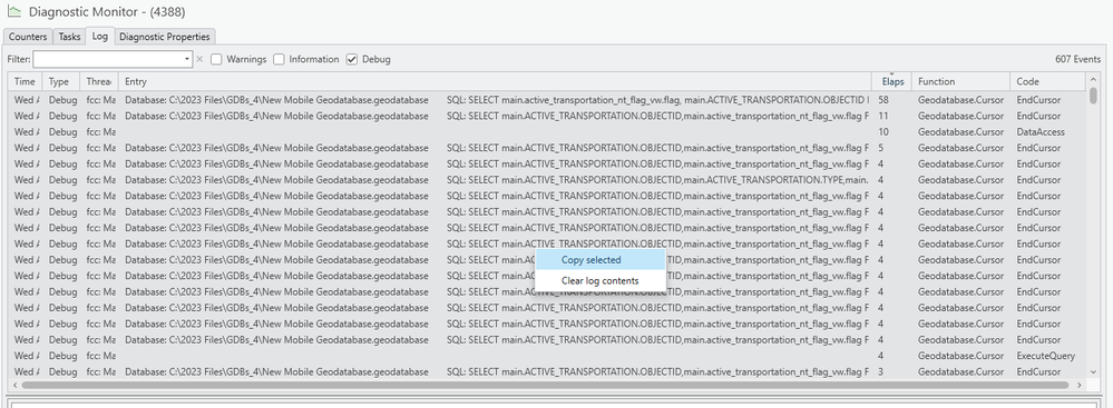

In the Diagnostic Monitor —> Log tab:
I can right-click the logs —> Copy selected:

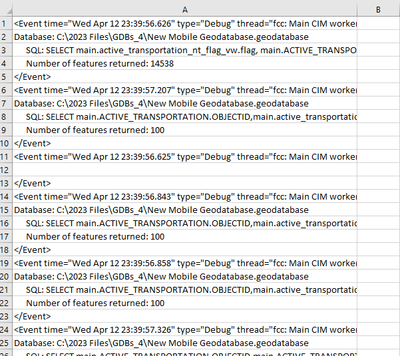

When I paste the copied values into Excel, the data looks like this:
The log values are squished into a single column as <tags>.
It would be better if the data was formatted as a table, similar to how it looks in the Diagnostic Monitor Log tab:
That would facilitate tabular analysis of the log data.
Could the Diagnostic Monitor logs be enhanced so that the data gets copied as a table, not as tags?

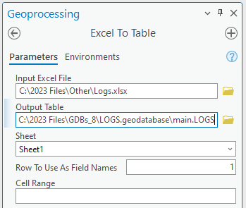

7. In ArcGIS Pro, create a new mobile geodatabase called LOGS.geodatabase.
8. Use the Excel to Table GP tool to import the spreadsheet to the mobile GDB as a table.
  1. Use these parameters:
  2. Click Run.
  3. The table has been created.
  4. Rename the table from main_LOGS to LOGS.  Reason: there's a bug.

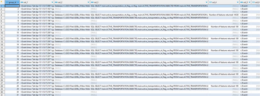

9. Run the following SQL query using a SQL client like DBeaver.
WITH cte AS (  --Related Oracle post: https://stackoverflow.com/questions/76024662/fill-in-rows-per-group-for-pivoting
    select sum(case when log_tags like '<Event%' then 1 else 0 end) over (order by id) group_id,  --https://stackoverflow.com/a/76021834/5576771
           case
             when substr(log_tags,1,13) = '<Event time="'                      then 'col_1'
             when substr(log_tags,1, 9) = 'Database:'                          then 'col_2'
             when substr(log_tags,1,10) = '      SQL:'                         then 'col_3'
             when substr(log_tags,1,16) = '      Number of '                   then 'col_4'
             when substr(log_tags,1, 8) = '</Event>'                           then 'col_5'
             else 'col_6' --Sometimes the values in cols 2-4 are different from what I'm querying for above. Col_6 is a catch-all for any unexpected values.
                          --However, col_6 will only grab the first unexpected value it comes across; all others will be ignored. I haven't found a better way to do it.
           end as type,
           log_tags  --substr(log_tags,1,100)
      from logs
     where log_tags is not null)
  select group_id,
         max(case when  type  = 'col_1' then      log_tags  end) col_1,
         max(case when  type  = 'col_2' then      log_tags  end) col_2,
         max(case when  type  = 'col_3' then trim(log_tags) end) col_3,
         max(case when  type  = 'col_4' then trim(log_tags) end) col_4,
         max(case when  type  = 'col_5' then      log_tags  end) col_5,
         max(case when  type  = 'col_6' then trim(log_tags) end) col_6
    from cte
group by group_id
order by group_id
  1. Note: I tried using the SQL above to create a database view in the mobile geodatabase. However, ArcGIS Pro didn't display the data in the attribute table correctly. Mobile GDB database view — CASE expression value shown incorrectly in attribute table. So I abandoned that idea.
  2. If you do try to create a database view, be aware that SQL comments are buggy in mobile GDBs when using the Create Database View GP tool. Example: SQL comment in WITH clause in mobile GDB database view. So you might need to remove the comments or create the view directly from a SQL client like DBeaver.
9. The resultset of the SQL query in DBeaver looks like this:
That's the desired result.
We can use that data to do tabular analysis on the logs when troubleshooting issues. We'd likely need to parse values from the columns to make the data useful.

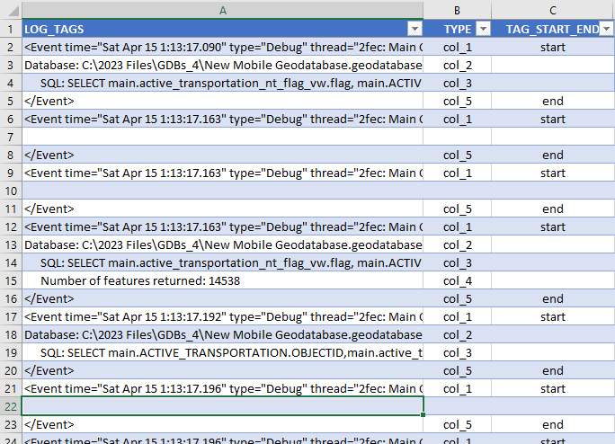

Option #2 - Use Power Query in Excel
10. Create a TAG_START_END column in the Excel table:
=IF(  LEFT([@[LOG_TAGS]],6)="<Event","start",  IF(LEFT([@[LOG_TAGS]],7)="</Event","end",""))
11. Create a TYPE column in the Excel table (see the CASE expression in the SQL query above for a more readable version):
=IF(LEFT([@[LOG_TAGS]],12)="<Event time=","col_1",
      IF(LEFT([@[LOG_TAGS]],9)="Database:","col_2",
          IF(LEFT([@[LOG_TAGS]],10)="      SQL:","col_3",
              IF(LEFT([@[LOG_TAGS]],34)="      Number of features returned:","col_4",
                  IF(LEFT([@[LOG_TAGS]],8)="</Event>","col_5",
                      IF([@[LOG_TAGS]]<>"","col_6",""

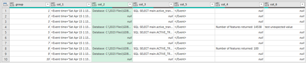

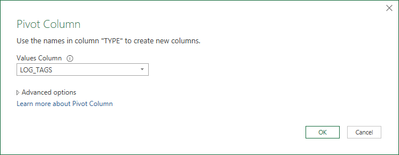

17. Pivot the data:
  1. Select the TYPE column.
  2. Transform tab —> Pivot Column.
  3. Values Column: LOG_TAGS.
  4. In the Advanced section, choose Don't aggregate.
  5. Click OK.

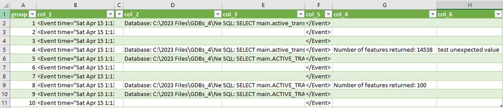

18. The Power Query should now look like this:
19. Click "Close & Load".
20. The resulting Excel worksheet should look like this:
21. I manually added column C to prevent the values in B from spilling over into the blanks in column C.
C = '      [there's a space after the single-quote]
22. Complete.

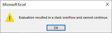

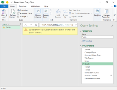

Note:
With certain log data, I get an error from Power Query:
Evaluation resulted in stack overflow and cannot continue.
I haven't figured out what specific log data causes that issue.
It might have something to do with the "Result" Power Query step:

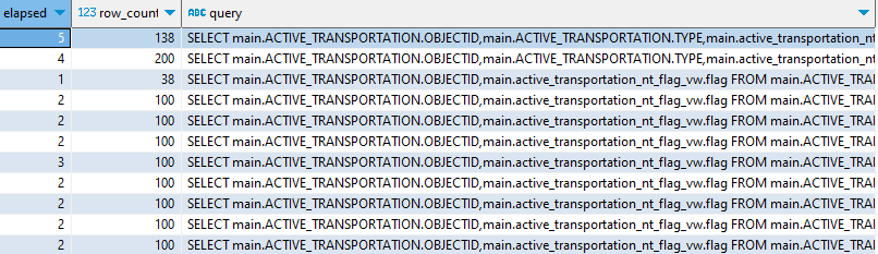

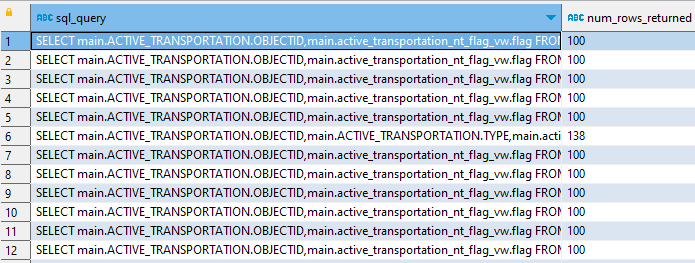

Here's a specialized SQL query that extracts information about query logs that returned at least 1 row:
--https://community.esri.com/t5/arcgis-pro-questions/mobile-gdb-database-view-case-expression-value/td-p/1279170
WITH cte AS (
    select sum(case when log_tags like '<Event%' then 1 else 0 end) over (order by objectid) group_id,
           case
               else 'col_6'
           end as type,
           log_tags
      from logs
select
    substr(xml, instr(xml, 'elapsed=') + length('elapsed=') + 1) + 0 as elapsed,  --https://stackoverflow.com/a/76078619/5576771
    row_count+0 as row_count,
    lower(query) || '; --Excel rownum: ' || (row_number() over() + 2) as query
    --lower(query) as query
from (
          select group_id,
                 max(case when  type  = 'col_1' then             log_tags      end) xml,
               --max(case when  type  = 'col_2' then             log_tags      end) col_2,
                 max(case when  type  = 'col_3' then substr(trim(log_tags), 6) end) query,
                 max(case when  type  = 'col_4' then substr(trim(log_tags),30) end) row_count
               --max(case when  type  = 'col_5' then             log_tags      end) col_5,
               --max(case when  type  = 'col_6' then        trim(log_tags)     end) col_6
            from cte
        group by group_id
        order by group_id
where
    row_count+0 > 1
