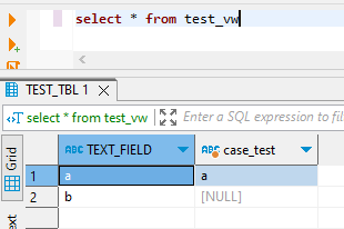

The resultset ought to look like this (DBeaver SQL Client):
