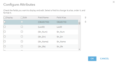

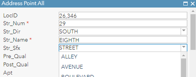

This appears to be fixed in the New Map Viewer.  However in the Classic Map Viewer, I am still seeing cases where this is not fixed. See screenshots below.  This is an address feature service published from our Enterprise.  All attributes are unchecked to disable editing of any attributes.
I can definitely still go into edit mode and expose every field for editing.
Thanks for the update @@MJBiazar , but ESRI may want to look into this some more specifically in Classic Maps.  I'm not sure why @GrantHoward1 was not seeing this in the classic map viewer but I certainly am. I  agree that this is a major oversight that could have some catastrophic consequences.  We as an organization have many edit apps out there and to think that everything is potentially exposed for editing every field is more than unsettling.

@GrantHoward1  After some further testing on my end, the issue appears to be fixed when I create a new map and use the same feature service and modify the display/edit attribute settings.  I wonder if the maps that I created before were during a window of time when this was not working and is persisting. The maps that I have tested were both created over the last couple of weeks.
Anyhow, I will follow up with ESRI support regarding the issue.  Thanks for your feedback.
