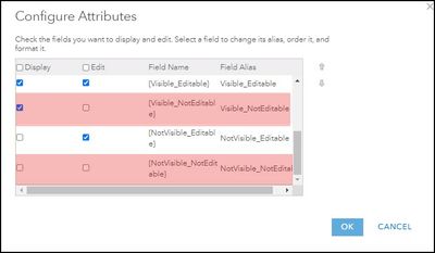

The problem that I'm having is that when using the New Map Viewer in ArcGIS Online to edit data in a web map, folks are able to view and edit all fields of the layer, even fields that have been set to not visible and/or not editable.
Background: I published layers and created views. After I created the views in AGOL, from the Data tab, I configured the pop-up to make some fields not editable but visible, and some fields not editable or visible, and several fields both editable and visible. Then I added those layers to a web map (classic viewer) and saved it.
Behavior in classic map viewer: when a user clicks on a feature and edits it, or adds a new feature, they do not see any fields that are set to not visible, and if the field is set to visible but not editable, they can see it, but they cannot add data to it (it's grayed out).
Behavior in new map viewer: when user clicks on Edit on the right panel and then chooses either edit a feature or add a feature, they have access to view and edit every field of the layer, regardless of the visibility and editability of the pop-up configuration. Now I will note that when a user simply clicks on a feature to view the information, the pop-up configuration is honored as far as which fields are visible. I do not see anywhere in the new map viewer where it is honoring the "Edit" property of the pop-up configuration that is set at the layer level.

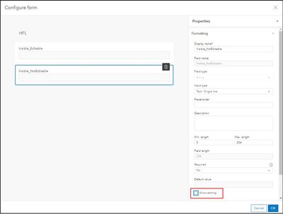

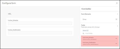

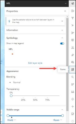

And... here is the more exciting part and a sneak peak to a new functionality in this ArcGIS Online release which provides a better experience for controlling fields visibility and editability.
Now you can use Forms (similar to what you might be already familiar with in Field Maps) in Map Viewer to control which field should be visible/editable on your map when adding/editing features.
I hope this answers your some of your questions and provides a viable solution. Please feel free to post any additional questions here or by reaching out to Technical Support.

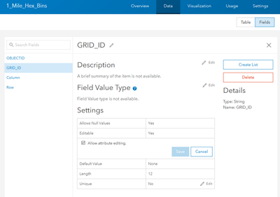

The workaround here (warning: it's tedious) is that recently AGOL added the ability to toggle editing per field. So I guess it's more accurate to say, if the layer is editable, all visible fields are editable if their settings allow it.
Item → Data → Fields → Field → Editable
It's a really fantastic addition, and you'd only have to change it once per layer / view, but there's not really another way around it at this point.

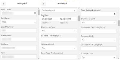

I'm also having issues with this.  I have a map I created in Map Viewer Classic.  By default maps now open in the new viewer so they do not honour the attribute editing settings I selected.
JimW
Same issue here.  Setting the Editable setting on the layer itself is not an option as some fields need to be editable at other stages of our workflow.

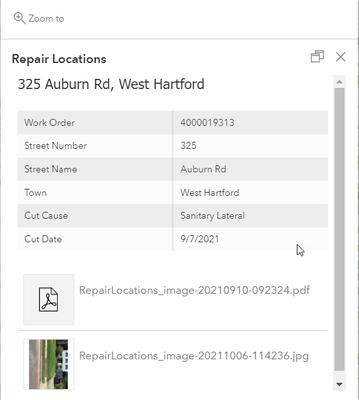

Here is my configured pop-up:
When someone goes to edit this same point every single field in the feature layer is available for editing.  I didn't include all fields but this demonstrates the issue.
This is not a good thing.  I'd like to see my pop-up as configured above but only the fields that can be editable will be editable.
