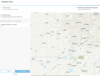

I have no idea why I can't update the view. This setting used to be in the visualization tab. Then it got moved to the settings tab. In the Update View pane I select my layer, then in the second step Update is greyed out. If the second step is optional then why is Update greyed out?

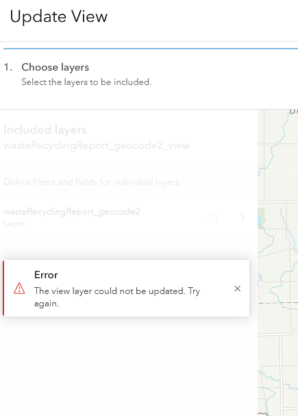

I don't need/want to change anything here, but it's the only way out apparently. So, I randomly set area of interest then hit Update. Then I'm hit with a vague error. Anyone know what's going on here?

Ah! I see. Yes, we also experienced something strange like this when we had a parent layer with views and an overwrite changed something on the parent layer.
If you know of a schema change ahead of time, it works best to change the AGOL layer's schema ahead of the overwrite. When you adjust the parent layer in AGOL, the views can sort of pick up the changes. When the overwrite makes schema changes, the views don't "see" it.
For what it's worth, we abandoned that approach entirely because of views getting broken like this. Instead, we use a script to either selectively apply edits to the parent layer, or else just truncate and append.

The Update button is greyed out until you make changes to your view (in your case, by clicking on the WasteRecyclingReport_geocode2 layer and changing the view definition somehow). If you want to exit without changing the view there is a cross in the top right corner.
I've not got a solution to your error, but there do seem to be multiple issues with views since the new Update View process was implemented in December. I've got several of these logged in a case, and have heard that others are also experiencing issues. Hopefully ESRI will resolve them quickly.

Thanks for the reply. When I initially posted I made changes to the view by defining an area of interest. Now I fumbled around in the Select fields part until Update wasn't greyed out. But, no matter what I get that error.

Do you have anything dependent upon the view, like a hosted map image layer? I had some weird behavior once when a hosted image was dependent upon a view.
Have you looked at your layer's JSON to see how the view is currently defined?

Thanks for the tips! The view was actually made from a published feature layer if that says anything. I ended up making changes in the script that published the feature layer, and instead of making a feature layer I did a feature class to feature class conversion--then overwrote the hosted feature layer. This changed something because now I can update the view.
