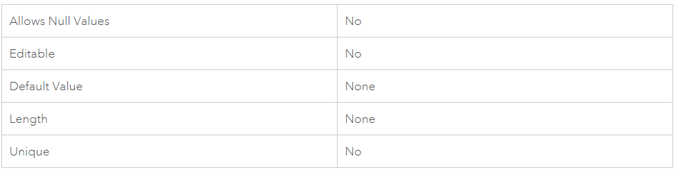

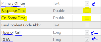

I wanted to let you know that I ran across another issue I believe is tied to overwrite process being unable to pass publish parameters... or... use existing rather than overwrite to an arbitrary default.
Below are a couple of screenshots showing some field settings of the layer I am overwriting with the script. Some of these fields, such as CAD ID Num, Case Num, Call Date, Primary Officer as a few examples, come directly from the CAD system data feed. Allowing nulls is understandable in some cases ( a case number is not generated for every CAD call  so some nulls will exist), and others are negatable (this data view pullls the last 180 days of data, if a call happened  before or after time existed {outside of the date/ time continuum} than it's kind of outside of our jurisdiction anyway haha). Hour of Call and DOW are built from the Call Date field, which allows null values but wouldn't exist if it were null... so they can allow nullls also without ever really noticing.
Highlighted in yellow are values that were causing some issues down stream when null values where allowed. When a call is closed a "final code/type" should be known upon completion... even if it is cancelled or deferred to another agency. Response time and on-scene time became an issue when creating dashboards and automating some industry standard metrics such as average response time... null values don't represent a "0" value and averaging wasn't performing properly.
 The 911 data is not shared with anyone for editing ever (in a GIS environment as a view layer extracted for a SQL database, Dispatchers do their thing in the CAD system)
Excel document outlining the schema for the layer and how to handle problematic null values.

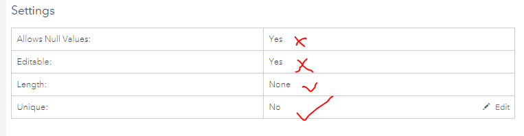

Once published using the overwrite script, many of these settings appear to be reverting... even one's that I specified in my sd draft definition.
For Call Date:
In Pro, I can't edit the layer and in my sd draft I have  enable_editing = False, allow_exporting = True)... surely the allow exporting is enabled.....
Oooohhhhh
The same is true for all fields, it just defaulted to yes and only the field type and length seems to have actually passed correctly.
The response time field I mentioned
Thank goodness any nulls that did exist were properly handled before this stage and it is a non-issue for the purposes we have.

Hi Brandon - thanks for the details here. See my responses below. Just to note, I did my testing using the FeatureSharingDraft class, which replaces the legacy CreateWebLayerSDDraft function. This may explain the differences seen with #1.
1) Null values and edit settings not being respected:
-I wasn't able to reproduce this, though I was testing from a FGDB instead of a view layer extracted from a SQL server database. In my case, both allow nulls and editable/not editable were respected:
Pro 2.6.2:
Online:
Below shows AnotherNoNullFld:
