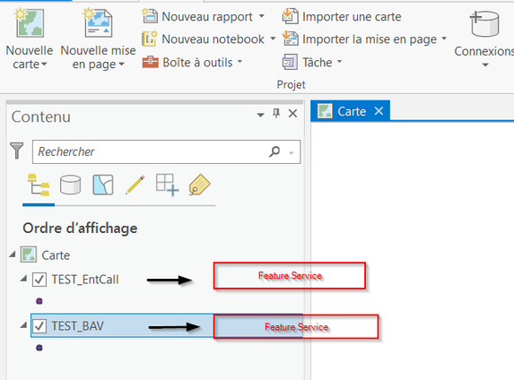

@JakeSkinner No, I modified the layers manually on Arcgis Pro, now I want to overwrite the old services that I had previously published...

what i want to do is reuse the script below but i want it to search each service and overwrite it with the new one...because my first script it publishes the layers separately as Feature Services.

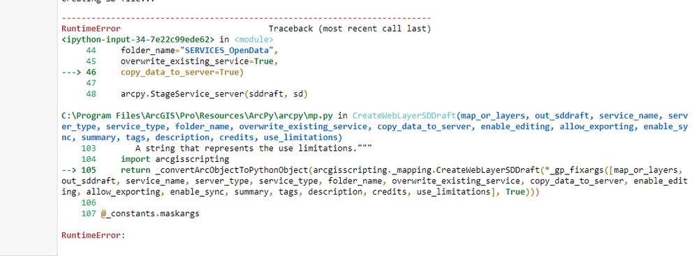

Hey @JakeSkinner , i get the RuntimeError :
inolaroch
Hey @JakeSkinner, I  modified some things and it worked perfectly, Thank you for your help 🙂
