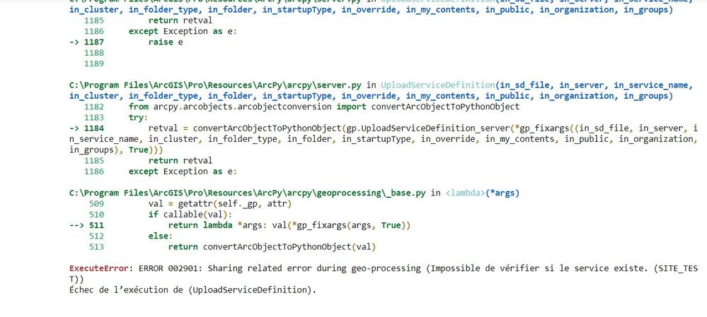

And I'm getting this error :
Can you help me please !
Thank you !
by Anonymous User
Not applicable
Hi @inolaroch - I noticed your other post where it sounds like you successfully published the first layer but the other layers in the map aren't publishing?
I would begin by inserting some print statements after your variables to see what values are going into the subsequent parts of the script. I'll also take a look on my end and see if I can figure out what is going on with it.
