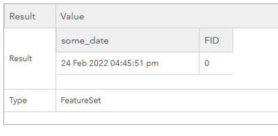

When creating a FeatureSet from a dictionary, as in Data Expressions in Dashboards, I cannot add a date to a date field.
In the simplest example, here's a single-feature set with a single field, which ought to have the current date/time in it.
var fs_dict = {
    fields: [{name: 'some_date', type: 'esriFieldTypeDate'}],
    geometryType: '',
    features: [
        {attributes: {some_date: Now()}}
return FeatureSet(Text(fs_dict))
However, this returns an empty set.
Casting the date as a number, however, seems to work. Replace line 5 with the following:
{attributes: {some_date: Number(Now())}}
And it returns my feature!

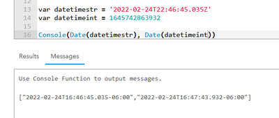

I thought perhaps this was due to a difference in how the text-encoded datetime was being read. Leaving it as the datetime gives me 2022-02-24T22:48:57.371Z, whereas the number returns 1645742863932.
But cast either of those as a date, and it reads them both in just fine:
So what's going on in the FeatureSet function? Why can it not handle text dates?
