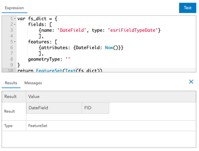

Why is this important, you might ask. For one, it offers a performance gain. Secondly, it addresses an issue that many of you have asked to fix: Allow Date() values in date fields (esriFieldTypeDate)
When you create a feature set using the old technique, the Text() function converts Arcade dates to an ISO8601 string. However, the FeatureSet() constructor from JSON text needs an EPOCH value. So, in the past you had to wrap your dates with a Number() function (e.g., Number(Now())) before you constructed your feature set. And, if you didn’t, you’d end up with what looked like a zero-row feature set returned.

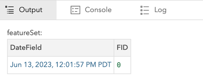

Now that FeatureSet() accepts dictionaries, dates don’t have to be cast to EPOCH. For example, the following will now execute and return a valid feature set.
var dict = {
  fields: [{ name: "DateField", type: "esriFieldTypeDate" }],
  features: [{ attributes: { DateField: Now() } }],
  geometryType: ""
return FeatureSet(dict);
