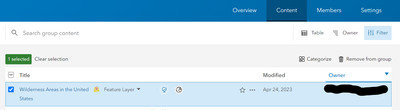

kcrocker_USGS
Turns out I missed a menu option!
For reference: go to the Content tab of the group, check the box for the item you want to remove, and  the "Remove from group" option shows up at top right:

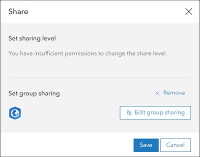

BernSzukalski
Esri Frequent Contributor
If you open the item that is in your group, you should be able to see the Share button. Since you are not the item owner you cannot change the share level of the item, but you can remove it from your group using X Remove.
kcrocker_USGS

BernSzukalski
Yes, another good (perhaps better) way to accomplish the task. At least one item has to be selected (obviously) to see the Remove button. But that way is better for removing a bunch at once, rather than having to open the item pages for each.
