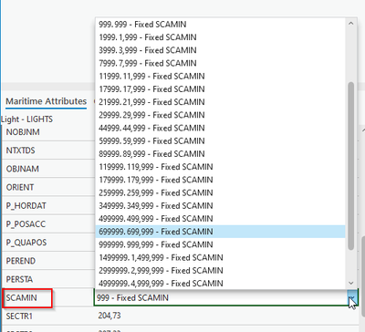

I can confirm that there is an issue with the SCAMIN calculation based on the configuration file. A workaround right now is to specify the SCAMIN step/fixed value on the features in the NIS.
Once you populate the SCAMIN attribute, SCAMIN will be calculated.
For guidance on specifying the SCAMIN value, refer to this help topic: https://pro.arcgis.com/en/pro-app/latest/help/production/maritime/override-scamin.htm
