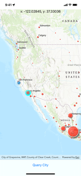

Query result highlighted in the feature layerQuery result highlighted in the feature layerHere, we have added a toolbar modifier to the map view and a Button called "Query City" to the bottom ToolbarItem. In the button, we created a task block, and called 2 asynchronous methods. First, we check then call the load() asynchronous method on the feature layer to ensure it is loaded, before we can perform any query on it. Next, we call the newly created async method queryCity(name:) with the try and await keywords.
In this example, a task block works well for 2 reasons. First, a feature table query often completes quickly and gives a deterministic result, so we don't mind giving up the ability to cancel the task. Second, since the method doesn't return any values, the task block is destroyed once it completes, making memory management easy.
Note: For simplicity, we omitted the error handling by using the optional try? keyword. You can use the typical do-catch statement to handle the error.
The load method is only called for demo purposes. In a real world app, the feature layer is implicitly loaded while the map is loading.
Run the app, pan to Los Angeles in the USA. Tap the "Query City" button at the bottom, and the circle symbol will be highlighted.
