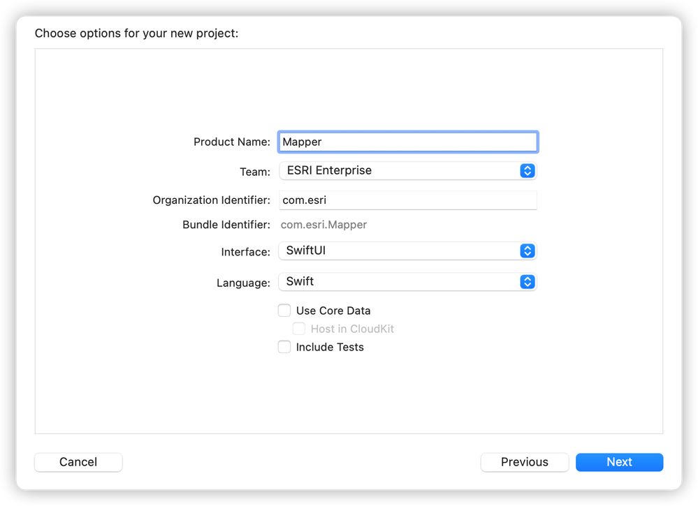

Let's start with creating a new iOS app project, Mapper. In the Interface menu, select SwiftUI.
Creating a new project in XcodeCreating a new project in Xcode
SwiftUI provides you with easy to learn declarative syntax code for you to design your UI. Watch your code execute in real-time using the live preview. No need to build. No more complex Storyboard (Interface Builder), constraints, auto layout issues, segue management, and view hierarchy difficulties!

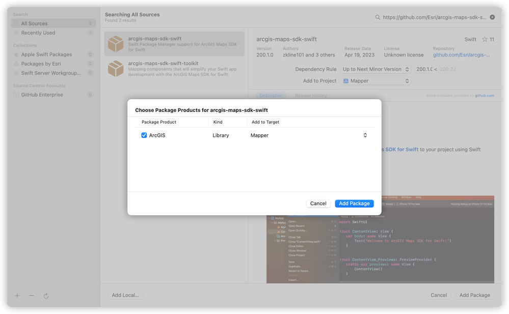

Adding Swift Maps SDK using Swift Package Manager
First things first, add the ArcGIS framework to your project dependencies using Swift Package Manager. Select File > Add Packages. Paste in the GitHub repository URL for the Swift Maps SDK: https://github.com/Esri/arcgis-maps-sdk-swift, and select Add Package.
Adding the ArcGIS Maps SDK for Swift packageAdding the ArcGIS Maps SDK for Swift package
Swift Package Manager is an open-source tool built and maintained by Apple for managing dependencies in Swift projects. It is integrated within Xcode, so you don't need to install a 3rd party program to use it.
As a Swift package, the Swift Maps SDK is much easier to integrate, compared to the older dependency management tools such as CocoaPods or Carthage, which cause conflicts from time to time. It also benefits from other enhanced Swift package capabilities, such as semantic versioning with auto update, offline installation as a local Swift package, etc.

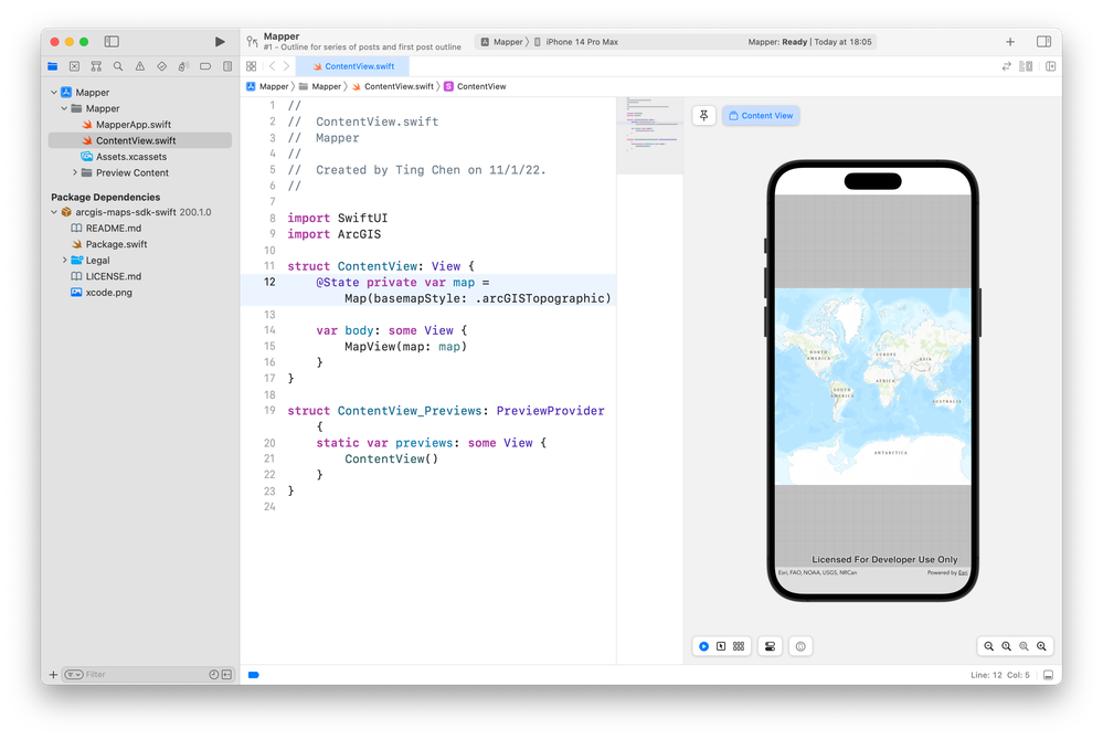

In ContentView.swift, you'll see a ContentView struct. You may already know that the body property is where all the views need to go. Replace the prefilled "hello world" text and image views in the VStack with the following code…
import ArcGIS
struct ContentView: View {
    @State private var map = Map(basemapStyle: .arcGISTopographic)
    var body: some View {
        MapView(map: map)
and you are all set - it's super simple!
Xcode interface with SwiftUI live previewXcode interface with SwiftUI live preview
On the preview canvas on the right side, you should be able to see the preview of ContentView, specifically, a blank view with a "Powered By Esri" attribution bar. If you don't see the preview pane, go to Editor > Canvas. Xcode will display an up-to-date preview as you make changes to the view's code. Make sure the Live Preview (the play button) on the lower left corner of the preview pane is selected, so you can interact with the preview in real time.

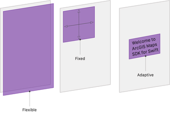

In the section above, we put a MapView in the body. By default, the view is centered. In terms of sizing, there are 3 typical sizes for a view:
  • Flexible: The view tries to take up as much space as it can on the screen. Think of a rectangle Shape. The MapView falls in this category.
  • Fixed: The view has a fixed frame, such as an image, or a view with specified fixed frame.
  • Adaptive: Depending on its content, the view negotiates its size with its neighbors. Think of a Text, whose size is influenced by font, line break, line spacing, word wrapping, etc. ArcGIS callout on a map view is an example.

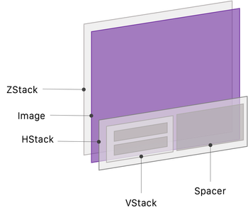

Wireframe showing the basic layout concepts in SwiftUIWireframe showing the basic layout concepts in SwiftUITo construct your custom view layout, use the HStack, VStack and ZStack layout containers. These are more powerful than the UIStackView and allow you to group collections of views horizontally, vertically, or stacked on top of each other. They are the building blocks that you can put inside other container views, such as List and ScrollView. These three kinds of stacks, with their alignment and spacing properties, view modifiers, and Spacer views, allow extensive layout flexibility.
