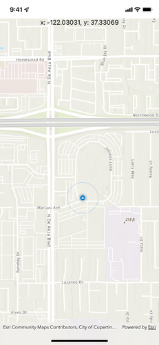

Location Display and real-time coordinatesLocation Display and real-time coordinates

When the simulated or device location changes, the coordinates are updated constantly in a Text overlay along with the moving blue dot. To achieve this, the location display object is added to the map view via the locationDisplay view modifier. The startLocationDataSource method starts the location display data source and displays the blue dot on the map view. Every time the locationDidChange method is invoked, the currentLocation property is updated and the Text view redraws and displays the latest coordinates. With this example, we hope you'll have a better understanding of how to use a "view model" to simplify a view.
