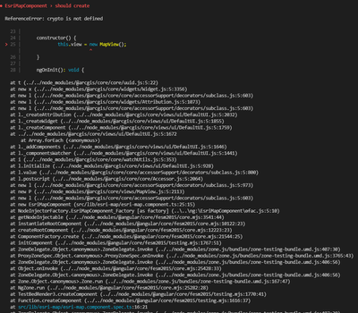

DanielFrunza
I'm using exactly your configuration in my project and I am getting the following error:
ReferenceError: crypto is not defined
on this line:
const view = new MapView({
Do you know what am I missing?
AndyGup
@DanielFrunzaare you using React or Angular? Crypto error sounds like React, and if that's the case here's a link to a repo that was mentioned above that might help you out: https://github.com/defiantgoat/esri-react-typescript
DanielFrunza
I am using Angular 13 and Jest 27 within a library inside an Nx workspace. The entire workspace is made only with Angular 13 and there is nothing related to React...
DanielFrunza
Here is the entire trace...
AndyGup
@DanielFrunza  Try removing the following line from \node_modules\@arcgis\core\package.json and then try again:
"crypto": false,
DanielFrunza
@AndyGup  I've tried. The same issue... 😞
AndyGup
Gotcha, thanks. It's not clear what is causing this issue, there are a ton of usages of crypto within Angular, when I searched for it in node_modules I got 690 results in 198 files including usage in TypeScript and Stencil. I tried some quick internet searches and can see this isn't a unique problem. What's interesting is crypto didn't get installed on my machine when I installed the sample project. Maybe Jest or Nx triggers something that requires it.

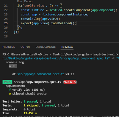

DanielFrunza
I think I found the issue... If you would add in your own spec file the "fixture.detectChanges()" you would get the same "crypto is not defined" error...
@AndyGup  do you know why is this happening?
DanielFrunza
@AndyGup I would say that your second unit test is not conclusive because:
You define the view to be null.
And the second test checks if the view is defined. If you would add a console.log you would see that the app.view is null! Because without the "fixture.detectChanges()" the "ngOnInit" method never gets called.
The test will succeed even if "app.view" is null. The test should be like this but it will not pass anymore:
