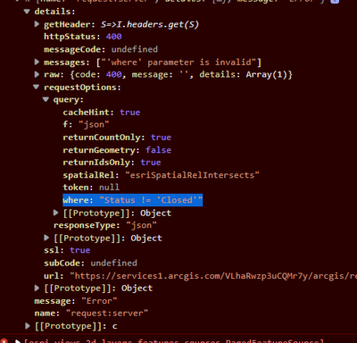

Hi All:
I want to be able to programmaticaly apply a "<>" operator to a definition expression. Nothing complicated, just something like layer.definitionExpression = "Status <> 'Closed'" because I don't want to include an OR clause in the query.
The error that I get is "'where' parameter is invalid" however if I try to apply the same query to the REST endpoint it returns the data fine. I tried encoding the string manually and also using encodeURIComponent, but neither worked.
Anyone have any idea what I am doing wrong?

KenBuja
MVP Esteemed Contributor
Use "!=" instead of "<>"
MichaelCollinsGIS
Unfortunately, I tried that too. No avail.

MichaelCollinsGIS
It's funny how a simple question can shake something important loose:
this.apply = function () {
    console.log(self.queryEditor.innerHTML); // prints "Status &lt;&gt; 'Open'"
    featureLayer.definitionExpression = self.queryEditor.innerHTML;
    featureTable.refresh();
Now obviously, changing that from innerHTML to innerText yields:
    console.log(self.queryEditor.innerText); // prints "Status <> 'Open'"
    featureLayer.definitionExpression = self.queryEditor.innerText;
And this works as expected.
Thanks for the nudge.
