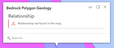

I am trying to access Related tables in an AGOL Hosted FeatureLayer using JSAPI(4.27) for display in a Popup.
I have tried adjusting the "Browse related records in a popup" code sample,  but am getting 'Relationship not found in the map' error in the popup.
I have added the FeatureLayer and the table as FeatureLayer and have used the "type: relationship" and the "relationshipID" found in the table service,  but still get the error. I have also 'loaded' the table per the sample.

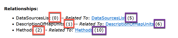

@Paco The number next to the relationship name is the relationship ID (outlined in red below). The purple outlined numbers are the layer IDs that participate in that relationship with the current layer you are viewing:
I would confirm you have the correct relationship ID configured along with the corresponding related data added/loaded into the map as a table or layer depending if it's non-spatial or spatial respectively.

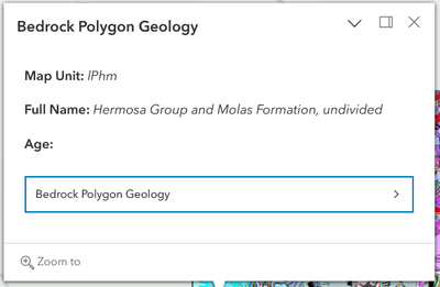

Now,  is there any way to simply show some of those related attributes in the initial text popup,  and Not on the second relate window in the popup?  I don't really understand the need for second click to open those related values?   if I use my popupTemplate from my Feature popup as my template for my Related Table, it does not show in the initial popup, but Does show in the related popup click window.  see my popup here-
first click Popup(missing 'Age')
second  'relate' click Popup(showing related 'Age' value)

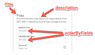

If you're wanting to show the list of related records from the selected feature's popup, the RelationshipContent allows you to display a list to drill down into the related record's popup templates themselves. Relationship content does not let you display all content from the related record's popup template in the list, only the title and a field you want to order the list by.
For example, the Browse related records sample shows the extent of what can be displayed in the RelationshipContent. The following image is the RelationshipContent element itself:
The orderByFields will display a field from the related data.

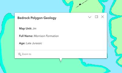

Thanks again for your response Lauren.   Yes, I only want display text from a Related Table to my original Popup.  which I can accomplish easily by permanently Joining the Table to my Feature.   But I am still confused as to how the ExpressionContent can access the Related Table(relationshipID: 1) without adding a 'type: relationship' to the content parameters?
the example doesn't explain a Table Relationship.  and some examples show using literals like backticks, and some dont for the Arcade statements?
I would love to see a very simple example of Relating a Table to a Feature Service Layer, and displaying some of the attributes from that Table in a Popup,  without the drill-down tabs.
I don't really want to Join Tables each time I update the dataset,  just for a simple Popup  😞
* I included a very satisfying Popup of what Im looking for, but using a Joined Table version of the FeatureLayer. "Age" is an attribute from the original Related Table.
