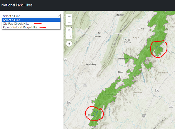

I am very new to using the ArcGIS JavaScript API, but wanted to utilize it to challenge myself for a final project in a course I'm taking. I am building a React application. For the MenuPanel component, the shenandoahHikesLayer and sceneView props are passed from the parent "HomePage" component.
What I am trying to accomplish is to create a dropdown menu and populating the values in the dropdown by querying the feature layer and pulling the "hikeName" attribute information for the dropdown values. (currently working). However, I want the sceneView to zoom to that feature when that option is selected from the dropdown, and that's what I can't get to work. Nothing is happening in the sceneView at all when I select various options from the dropdown menu.
Here is the code for the MenuPanel component:

Here are some screenshots:
Correctly pulling the hikeName information from the feature layer (right now only two features). But nothing changes in the sceneView when I click on the names in the dropdown.
As far as I can tell both the map and the layers are in Spatial Reference wkid 4269.
Any help would be greatly appreciated! Thank you so much!!
