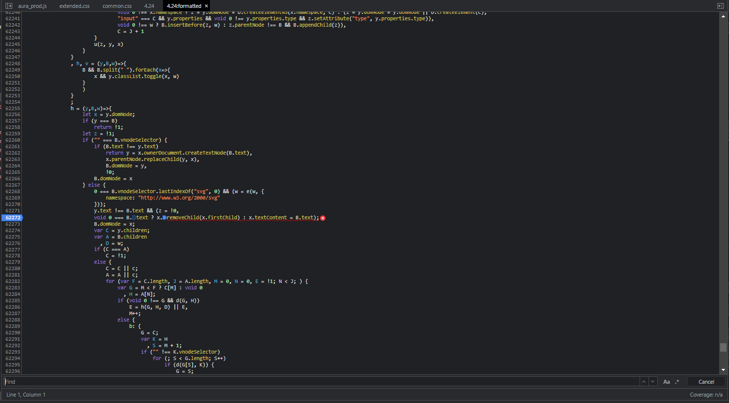

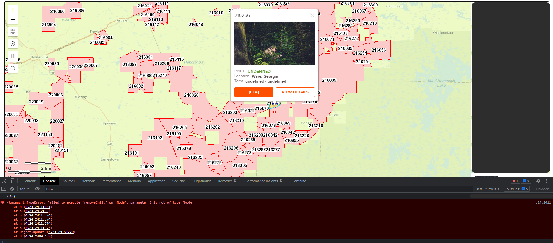

I have a strange exception in my implementation. The problem is when there is a popup in display, and if I want to zoom out, the Esri Library is throwing an exception. 4.24:2411 Uncaught TypeError: Failed to execute 'removeChild' on 'Node': parameter 1 is not of type 'Node'.
I'm not sure if it is related to my implementation. If required I can also share what I'm doing within JS.
Attaching this as well, maybe it helps.
UPDATE:
I found the problem source. It is the renderer that I have for my sublayers. When I remove them I'm no longer having the exception but I don't understand what is wrong with my renderer:

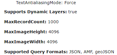

< true
Noah-Sager
It would help to have a working app to debug. Are you getting any useful errors in the console? Did you verify that the MapServer supports dynamic layers from REST? E.g.
https://sampleserver6.arcgisonline.com/arcgis/rest/services/Census/MapServer

UgurcanErkal
Hi Noah,
Yes, the MapServer supports dynamic layers. POT:
As for the error message, I attached it to the original post. I only see a Javascript exception but not an indicator of the cause.
