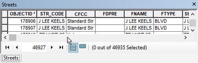

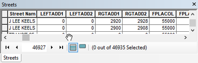

How to demonstrate the problem:
We're talking about when you click on the horizontal scroll bar between the endpoints and not on the slider to move the table view one page to the right or left.
Let's start with ArcMap.  Previously, ArcMap, and nearly all other table display apps have the following behavior.  When you click the mouse as described above then the table scrolls one horizontal page to the right so that the right-most, partially-visible field is placed at the left side of the table window, fully visible.  This is a very intuitive display strategy and all other apps that I know of use it.
Before:
After:

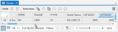

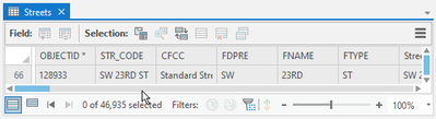

ArcGIS Pro (Pre 2.8) tried to mimic this but awkwardly failed to properly place the right-most, partially-visible field  on the left side of the table display and usually placed it completely to the left of the visible fields forcing the user to scroll back to the left a little to see it.
Before:
After:

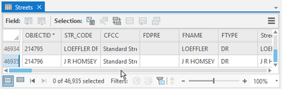

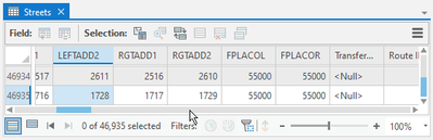

ArcGIS Pro 2.8
Perhaps someone complained about the above problem, because at ArcGIS Pro 2.8 the behavior has been changed as follows.  When you click on the scroll bar, instead of scrolling a whole page to the right, now the table display window only scrolls exactly 55 millimeters to the right, forcing the user to click 3,4,5 times or more to scroll the table one full page to the right, depending on how wide the table display window is.  It always scrolls 55 millimeters left or right regardless of how wide the fields are or how wide the table window is.  In the example below you can see that the table only scrolls about 2 1/2 fields to the right.  Additionally, like pre-2.8 versions, it still suffers from the problem of truncating the field on the left side of the table display window instead of placing the left edge of the field there.
Before:
After:
Do we need to make a new Idea to get this taken care of?

Thanks, David.  We're looking into this, but for now, it doesn't sound like an appropriate idea.  I'm checking with the development team and will circle back with you soon.

For the comment about page scrolling in the attribute table, [BUG-000141718: Clicking on the empty scrollbar space, or using the Page Left/Page Right context commands, on a table should scroll a full page of columns.] was submitted with technical support and should show up shortly on support.esri.com.  If other community members happen to discover this thread and are experiencing the same issue, search for that bug number on support.esri.com and click Subscribe to get set up for notifications and increment the count of affected customers in our support system.
