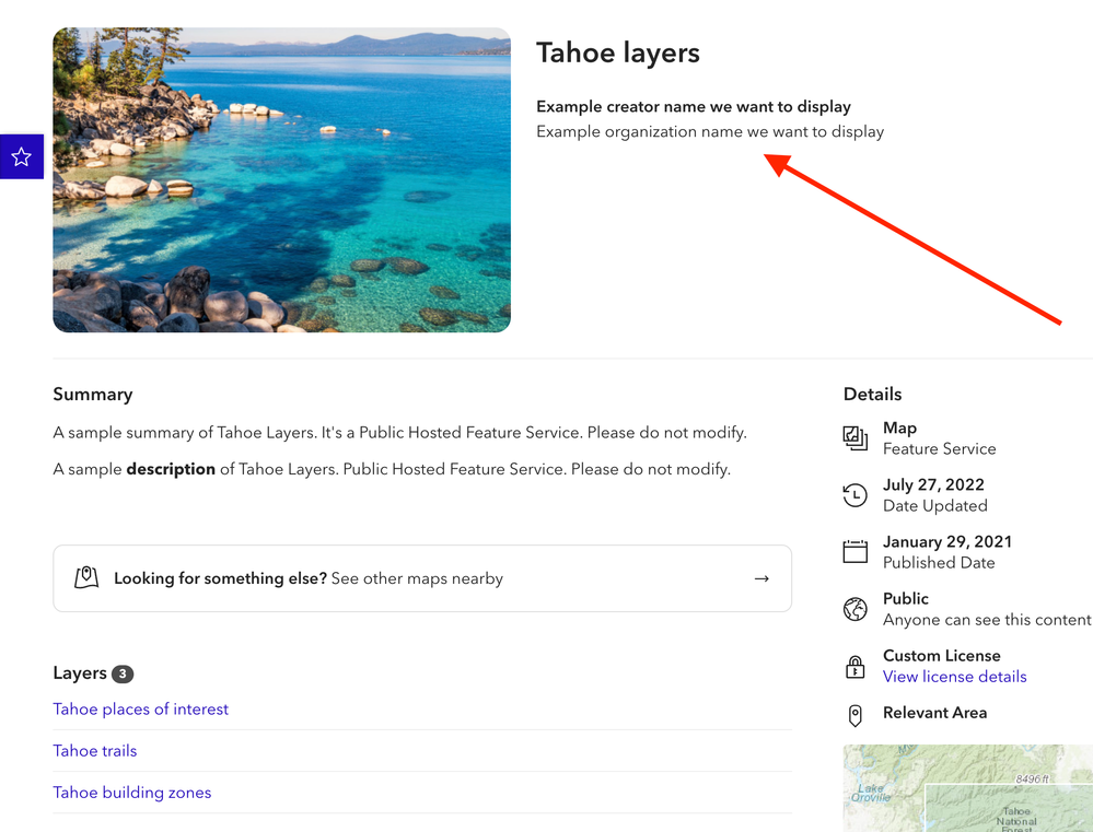

Above is a screenshot of the Metadata editor in ArcGIS Online for the Tahoe Layers item. We have added contact values for the “Individual Name” and “Organization Name” fields.

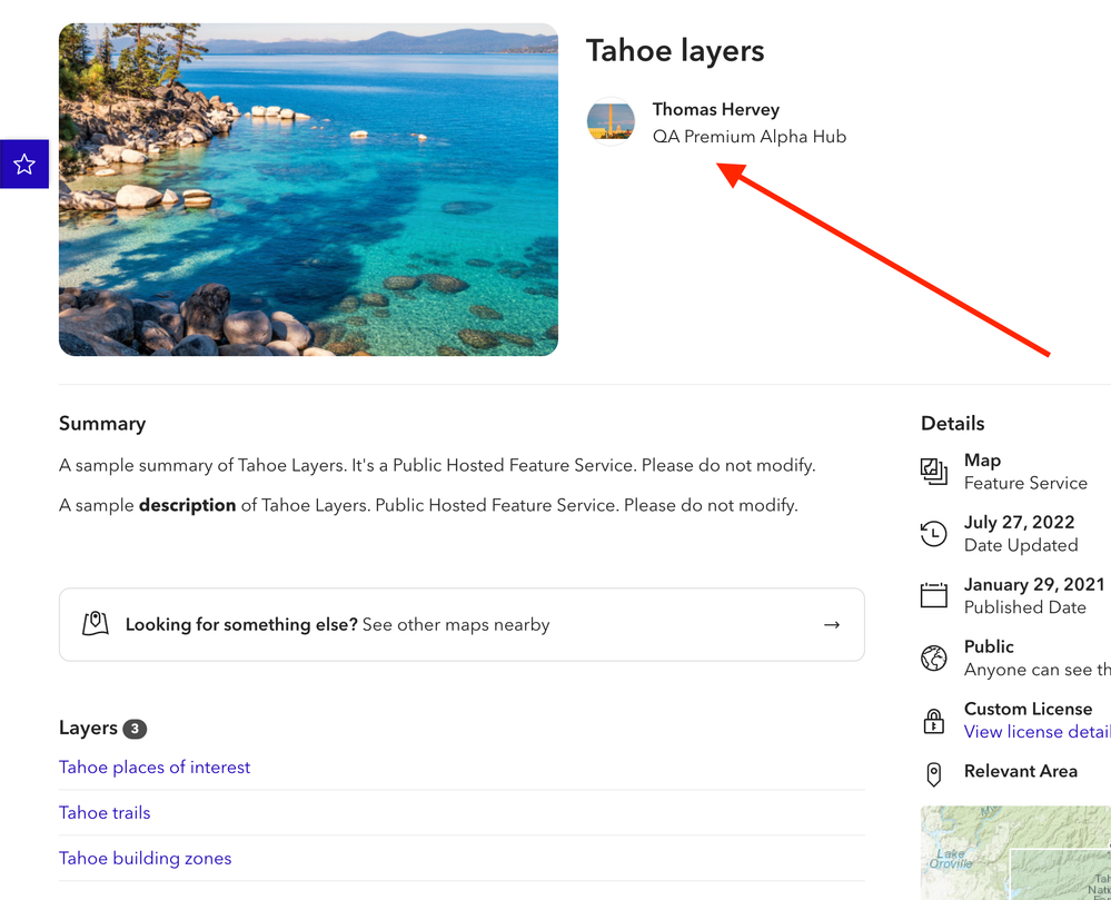

Above is a screenshot of the Tahoe Layers content view page in ArcGIS Hub. The newly added metadata fields are shown in the creator and organization labels.

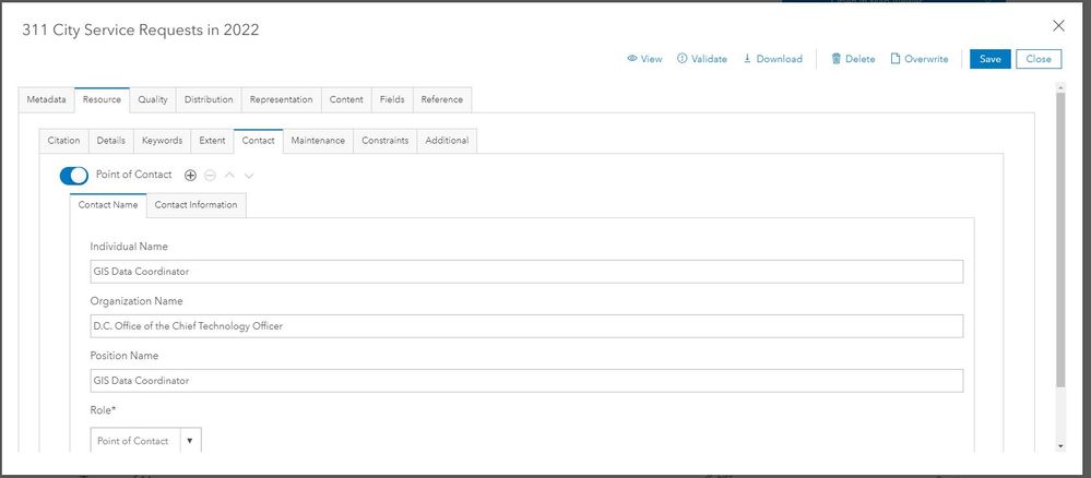

This update presents a new issue for me. Much of our metadata cites our distributor as the organization name (DC Office of the Chief Technology Officer) with the manager as individual name; it is not left blank as this article suggests. The update will overwrite DCGISopendata in all of our content. Users accustomed to seeing DCGISopendata in organization searches - in ArcGIS Pro, ArcGIS Online, ArcGIS Desktop - will now see "DC Office of the Chief Technology Officer." In hub searches they're used to seeing "Open Data DC." Please correct me if I'm mistaken. I hope I am. See the image showing what many of our items include now. Shown on hub site.

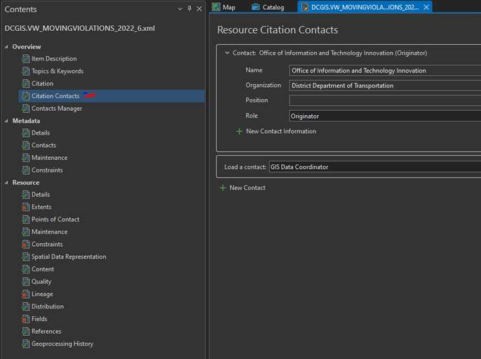

Good morning @ThomasHervey1 - continuing to better organize here. Our analysts author metadata within ArcGIS Pro and then push to ArcGIS Online. I'd like to update the team on how to cite originators vs points of contact so they appear in hub correctly. The metadata manager in Pro is different than the mapping you describe here.
  • Will hub pick up citation contact within overview? How is overview mapped to AGOL?
  • We specify originator vs point of contact. Will originator be prioritized?
In the image below we include the originating agency under Overview > Citation Contact. This is the preferred creator and organization label to show in hub. Under Resource > Points of Contact is where we plan to place the poc/distributor. Is this correct?
