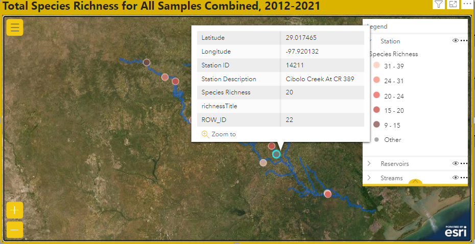

I created a map visual, and there are some odd unspecified fields in the tooltip pop-up. I've never liked how the lat/long automatically shows and cannot be removed, but now the variable I am using for the dynamic visual title appears in the tooltip as well. Not the value, but the actual variable name (richnessTitle). I do not have this in any of the fields, it is only specified as the variable for the visual title. Also shown is ROW_ID. What is this and is it possible to get rid of it? It's not in my table that I can see. This is incredibly frustrating as it makes the map visual virtually unusable when there are nonsense fields shown that will only confuse the end-user. Am I overlooking something? Screenshot attachedrichnessScreenshot.PNG

Thank you for posting your feedback here and we will definitely be in touch! I agree with you on the X,Y having no value in the pop up, but originally this was spec'd out as a requirement. Overtime we feel the need to change direction on this, and we are looking to make some short and long term improvements with map tips in the visual.
Are you using ROW_ID in anywhere in the field well?

Not using ROW_ID anywhere. It's not even a field in my tables. the richnessTitle isn't in the field wells, it's only being used in the title of the map.

If you can shoot me the PBIX file we can take a look. I suspect we're aggressively taking any field used anywhere and throwing it in the tooltip. We are in process of reviewing the tool tip experience, so we can improve this in a future release.

Hello all, this is happening to me now, same ROW_ID field in the tool tips box when you mouse over a location.  Any solution so far? Thank you!

We're seeing the ROW_ID on our side too and will get an issue to fix that. It's definitely a bug. That said we are looking at ways to improve the map tips and provide a better experience.

Is there any update on this subject? I was trying out the ArcGIS visual today and am also seeing ROW_ID as a tooltip with no way to remove.

Yes, the ROW_ID has been fixed in a release that has been handed off to Microsoft and we expect to be in production within 2 weeks.
