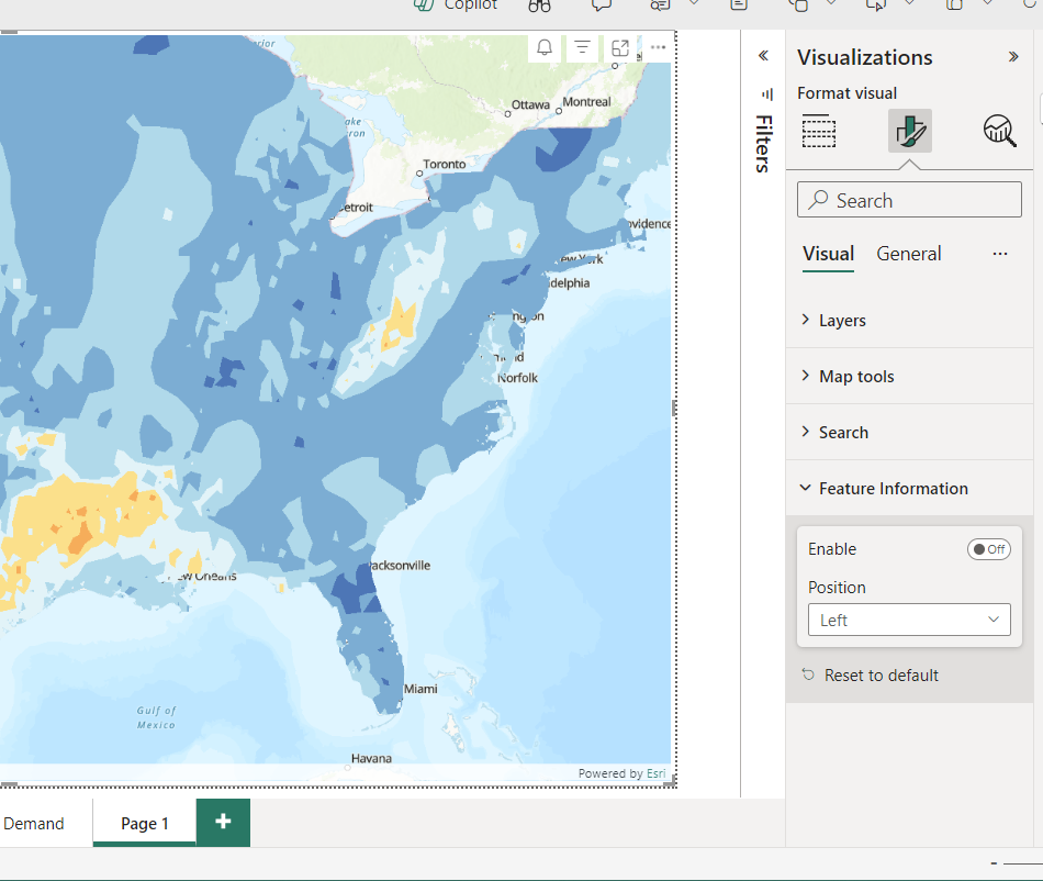

I am having a similar issue but when I toggle the Feature Information button ON, it instantly resets to OFF. I've tried logging in and on of both Power BI and ArcGIS Online and I am clearly able to import data from ArcGIS Online from my account, I just can't use the information. Like many other users, my projects were working flawlessly until the June update and now the link to ArcGIS Online is more fickle and don't have the full functionality. Can you provide any remedy for this problem? Thanks!

Hey @EmilyOlack, I've tried a few different things here but still no fix:
  1. I created a new WebMap on ArcGIS Online from existing features in my Organization, changed the symbology, saved it as a WebMap, and then imported that map to Power BI. Same thing where the data come into Power BI with the correct formatting but I can't interact with the data and the Enable switch bounces back to OFF when clicked.
  2. I tried importing a single layer from ArcGIS Online directly to PowerBI but same result.
  3. I tried uploading a new shapefile to ArcGIS Online and saving it there (thinking maybe there's a new format/feature that gets added when the layer is saved) and then pulling to Power BI but still same Enable switch issue.
When your team recreated the maps, did you do so on ArcGIS Online or ArcGIS Pro and pushed it to Online? Still trying to troubleshoot here so I appreciate your response.

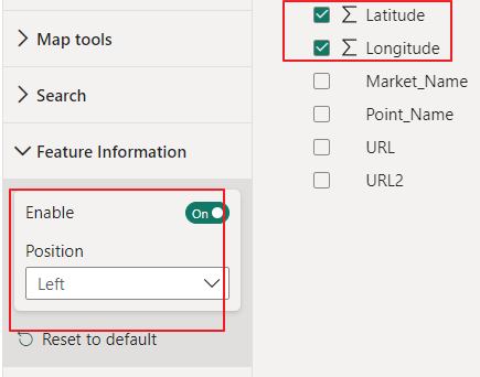

AdebMoustafa
Hi,
try to add any of the field in location, feature information is enable as like below:

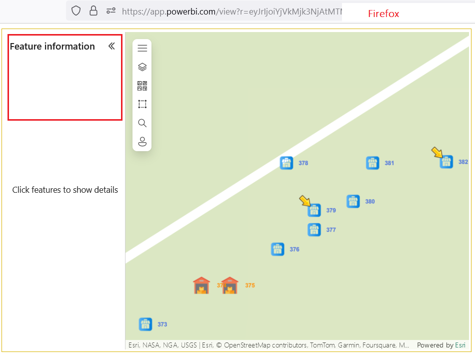

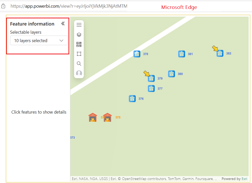

AdebMoustafa
Hi @NaZhang_Esri
I noticed that there is no issue when I open the Power BI link in Microsoft Edge, while the problem appears when I open the link in other browsers like Google Chrome or Firefox.
Do you have any explanation or solution for this problem so that I can open the link in any browser without issues?
