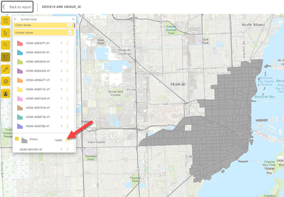

Hi there @DavidLeitson . I had a look at this issue and I see what the issue is.
By default, we take the top ten categories to classify data when using string values. As I look over this sample data, there are over 15,000 rows/counts in this dataset.
This was causing Power BI Desktop and Power BI Online to freeze and ultimately lock up. This was because Power BI was attempting to process the data. In this case, we are reaching the upper-limits of Power BI Desktop when using this amount of data. If I had to guess, the data is appearing as grey because the values are in the "others" categories.
