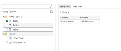

I have tried Get Data > Web and entered the URL (copying the URL of the feature service in ArcGIS Online).
Then I get the following:
I am not sure what to do next. Is copying the URL from ArcGIS Online enough information?

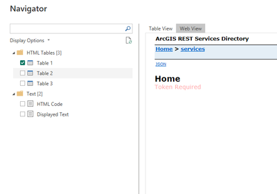

https://resource.esriuk.com/blog/how-to-use-arcgis-with-power-bi/
I've been trying to use this website and it's getting me places, but trying to figure out the token error.

We have a power bi query going which attached the correct feature service and appears to correctly pass though the authentication token which is great.
We used this guide https://resource.esriuk.com/blog/how-to-use-arcgis-with-power-bi/ to format the query, however we had to modify the url slightly in the example from  /FeatureServer/0/query? to /FeatureServer/0?query? to get this to work.
The next step in the instructions is to drill down into the features list, however we don’t see the ‘features’ object as per the screenshot below.  We see most of the other fields, but ‘features’ is missing.
The features list object unlocks the attributes object which ultimately unlocks the fields from the dataset.  Clicking the other list objects (like ‘fields’ in the example) returns just metadata columns, not the data columns.
Any ideas would be greatly appreciated!

Basically, there are 2 options:
1. share your service with everyone.
2. use a "proxy service" with stored credentials if you want to avoid the token. please follow this solution:
Limit access to public ArcGIS Online layers - Information Lookup | ArcGIS Solutions
