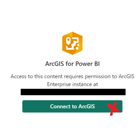

We are currently facing an issue with logging in to access a map in our published Power BI dashboard, which is powered by ArcGIS for Power BI. Up until last week, everything was working fine. However, it seems that the latest update to ArcGIS for Power BI might have caused connection issues.
When users of the published dashboard attempt to sign in to access the map in enterprise mode, clicking the button does not initiate any action.

The map works for one day and then when users open the dashboard the next day the button does not work again.
It would be a hassle, to tell users to clear their cookies every day just to access the map. Any thoughts on how to resolve this? Thank you.

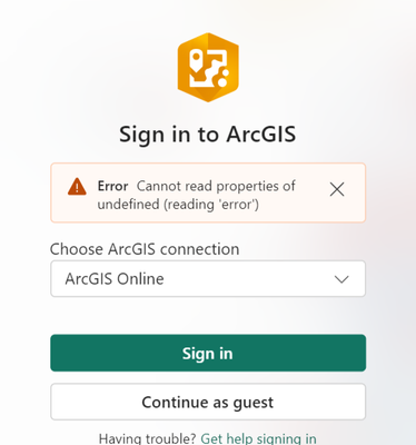

I tried creating a new map on the Power BI desktop and when it asks you to sign in to the ArcGIS account. A 'reading error' pops up. (See image below).
It is the same error as what users reported in https://community.esri.com/t5/arcgis-for-power-bi-questions/issue-with-gis-map-on-power-bi-since-the...

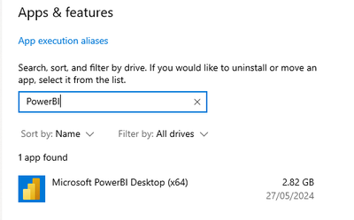

Also, I would like to confirm that you do not have two versions of Power BI Desktop on your machine. In some cases, you might have the Microsoft Store version as well as the .EXE version. There can be some conflicts with updates and sending information into Power BI Online
-Stupid question, how do I check whether I have two versions? I only looked at add or remove programs in the system settings and only one showed in the results.

The issue as expected was fixed for two days and then it returned. The sign-in button is still not responding and when creating a new map element, the 'reading error' still pops up.

P.S. I also checked and confirmed that I have only one version of Power BI Desktop
