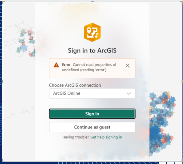

I signed into Power BI this morning to update June's data. I was prompted to sign into ArcGIS, but when I clicked the sign-in button, an error message appeared. Attached is the screenshot.
This issue happens on my PowerBi Workspace and PowerBi Desktop app.
Everything worked fine on Thursday, so I am assuming the ArcGIS User Types update threw something off. Any ideas on how to fix this or any workaround ideas?
MohamadChibli
Depending on which platform you're accessing the PowerBI, clearing the local storage should fix this issue.
https://doc.arcgis.com/en/microsoft-365/latest/power-bi/clear-browser-local-storage.htm

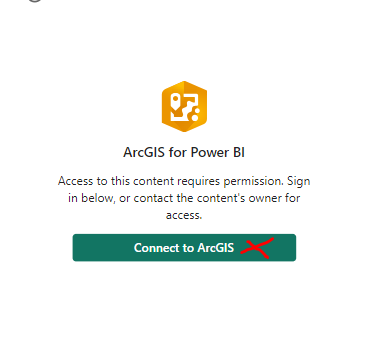

I have the same issue. I try an login to Powerbi Esri map and when I click to connect nothing happens.
PaigeHansen
Thank you! I followed the Power Bi Desktop instructions and it worked perfectly!

I have the same issues as @AlexL_QED . We have a map powered by ArcGIS for power BI in a published dashboard that worked before the update. After the update, the map access button does nothing when users attempt to click it. The solution of @MohamadChibli works for one day and then when users open the dashboard the next day the button does not work again.
It would be a hassle, to tell users to clear their cookies every day just to access the map. Any thoughts on how to resolve this? Thank you.
