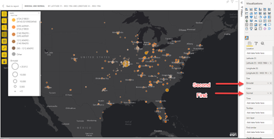

Here is an example of a numeric value being added to the size field-well first and then color. In this instance, I have classified the size value into different groups or buckets, while the color ramp is continuous.

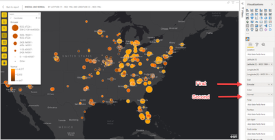

Here is an example of a numeric value being added to the color field-well first and then size.

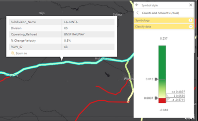

Thank you.  I am actually using the same data field for both color and size.  What i cant figure out is why can i not add as many conditional formats for color as i want?  Here is an example.  % change Velocity is 8.8%.  this is considered good.  The line is colored a light shade of yellow/green but i have it set to display as dark green.   what am i missing?
MarkFleet

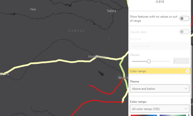

also, the classify data is grayed out so i cant add additional classes.  This is a Above and Below theme, but i've tried them all and cant get to work.
