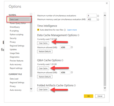

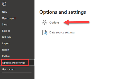

There are two areas where the cache can be cleared in Power BI Desktop.
  1. Within Power BI Desktop, navigate to File > Options and settings > OptionsAnthonyLatini_0-1630940594284.png
  2. Under Data load, click the Clear cache button under the three sections highlighted in the screenshot below.
  3. Close out of Power BI Desktop
  4. On your local system, browse to the following folder location: %LocalAppData%\Microsoft\Power BI Desktop.
    For example, <user>\AppData\Local\Microsoft\Power BI Desktop
  5. Delete the folder named CEF.
