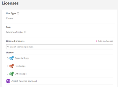

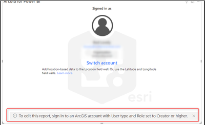

I was having the same problem with User Type 'Creator' and Role 'Data Editor'.  When I created a new ArcGIS visual, it displayed this message at the bottom:
I reported this to my ArcGIS administrator.  He said there is no "Creator" Role available by default (he said the next level up is Administrator), so he created a custom role "...that basically lets you do all the sharing and editing that you should want without having administrative overreach"
Here's what my settings in AGOL now display (note that PowerBI Power User is a custom role):
Whatever settings my Administrator applied to this new role resolved the issue for me.
I think Esri needs to re-evaluate the message as it seems to indicate that there is a Creator Role available when in fact there is not. Perhaps loosen the requirement to User Type = Creator and Role = Data Editor

As a note, we have identified a bug in ArcGIS for Power BI where you might see the following toast message even if your user account is set up properly.
To resolve this issue, simply add a new page to the bottom of the report page and tab between them. The toast message should disappear and the analysis tools should appear once you add data to the map.
