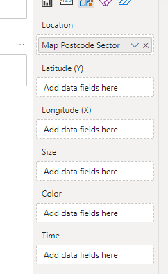

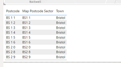

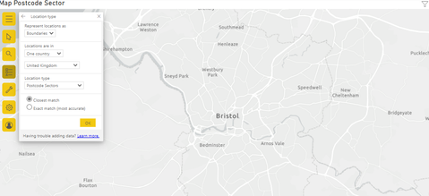

I've attached images of the exact "location type" set up used, and the blank map it renders. I've also attached an image of the postcode sector data being fed (Map postcode & Postcode fields do not work, tried both. The difference between these map postcode is that it removes middle whitespace formatting, which in the past caused issues with ESRI loading in the postcode sector boundaries).

I have carried out some testing with that dummy data and I can confirm the behaviour you're experiencing. I have fiddled around with the data a little and found that as we are locating via the postcode sector, having the space in the formatting is actually what is stopping the process. I removed the space so it is formatted BS11 instead of BS1 1. It's a little awkward I must admit, but you should find that it locates and visualizes correctly like this.

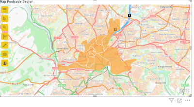

I've managed to find a workaround, or potentially the cause of the issue? Out of complete chance, I noticed the postcode sectors render correctly if the final whitespace on a postcode is replaced with an underscore.
I.E BS1 1 = BS1_1. Written some jank dax to fix the postcode sector field, that takes into account the necessary removal of the first whitespace, and replaces the second whitespace with  an underscore:
SUBSTITUTE(left([Postcode],4)," ","")&SUBSTITUTE(RIGHT([Postcode ],2)," ","_")
