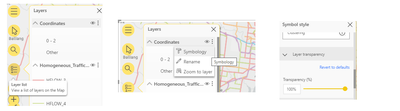

You can find the option to change transparency in Symbol style
Layer list > Symbology > Layer Transparency
Hope this helps.

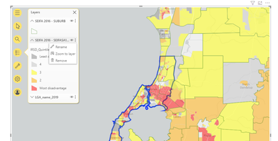

Thank you Manish~ This is my map, not sure why it didn't show the option of the symbology ?

"The Symbology option appears only on layers created using Power BI data." according to this: https://doc.arcgis.com/en/power-bi/design/change-layer-transparency.htm
