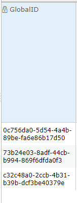

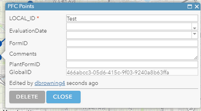

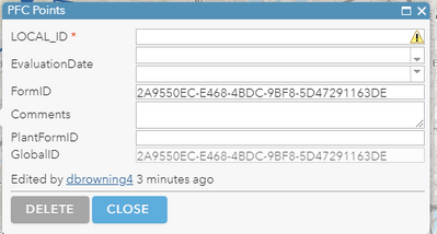

If I add a feature in a web map in the browser I get uppercase GlobalID.  If I use the exact same map and add in Field Maps it does lower case.
AGOL Add
Field Maps add
Then ArcPro changes the lower to upper for display
So the exact same record shows lower in AGOL and upper in Pro.
