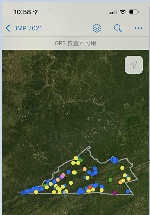

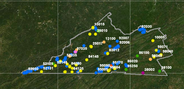

We created a Web Map using the ArcGIS online Map Viewer Classic with our Stormwater Basin points on the map. I labeled the points by their IDs, and they are showing up in the Web Map.
However, when I opened the map in Field Maps (22.2.0), the labels were not showing up.
The visibility range was set from world to room. The labels are showing up correctly in Collector. Actually, the labels were showing up before in Field Maps. This happened recently. We did update our Stormwater Basin fs 2 weeks ago. Link to the fs.
I also tried creating a new map using the new Map Viewer, but the labels were still not showing up in Field Maps.
Any help would be greatly appreciated!
