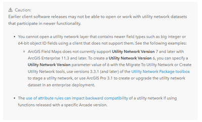

And I've found my answer:
https://pro.arcgis.com/en/pro-app/latest/help/data/utility-network/utility-network-compatibility.htm
Hopefully the new update for Field maps will arrive soon, because the beta version seems to work fine.

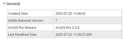

Can you please identify and share the utility network version being used here? This information can be found by doing the following:
  1. Add utility network to a map in ArcGIS Pro
  2. Right click the utility network item in the contents and select Properties
  3. Select the Network Properties tab
JoëlHempenius3
Hi @BenjaminSegal
here it is:
-Joël Hempenius.
