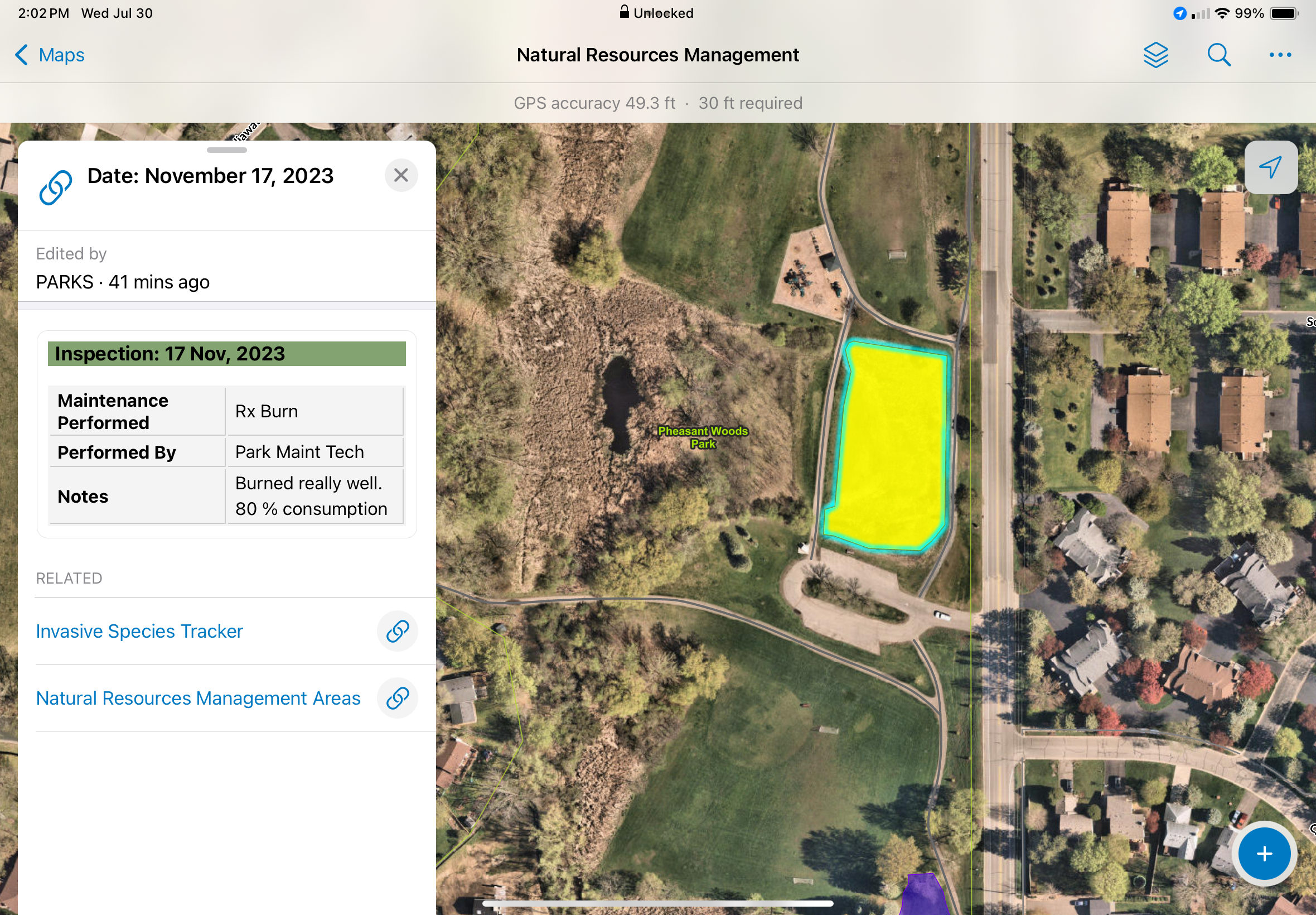

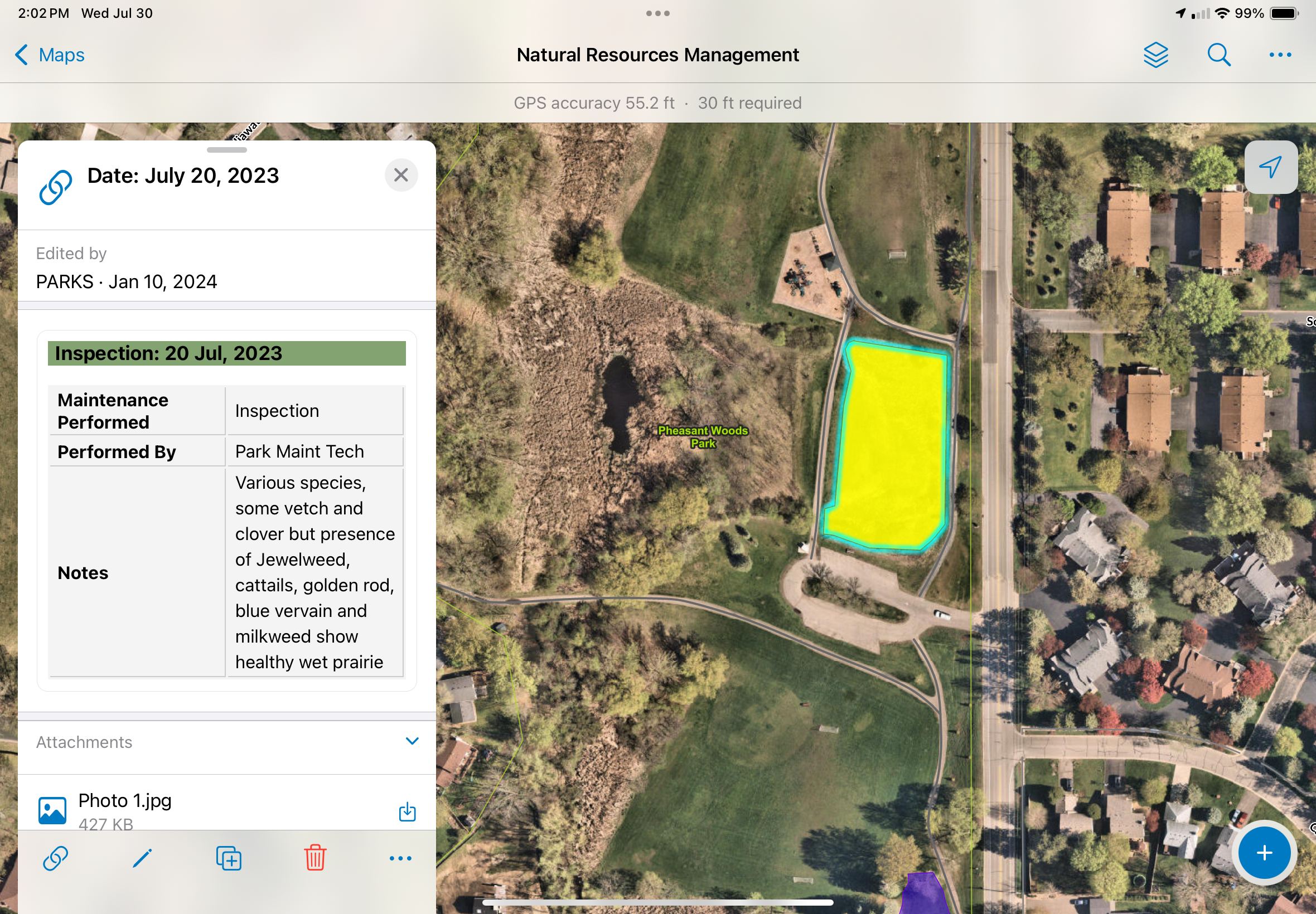

Weird one today. I have a referenced feature service published and added to a map that gets used in the field. Among other things, the map has a feature class that has a relationship to an inspection table. The inspection table has attachments enabled. In Field Maps, myself and users are able to edit the parent features and add records no problem. However, we're seeing an issue where records already created are only editable if they have attachments.
There are no errors at all, but when selecting an inspection record that does not have an attachment, I don't even get the edit icon. As an example, here is a feature with two related records. One has attachments, the other does not:
As you can see, I can only work with the form for the one that has the attachments. I have confirmed this is true throughout the dataset. Poking around some other maps with similar configuration, it seems that when the related table has a popup configured using Arcade elements, this behavior reproduces, but if the related table has a popup using just a Fields List, then it does not. So for reference, here is the Arcade making the popup in the photos above:
