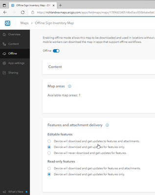

RhettZufelt
MVP Notable Contributor
I use the offline setting to get features only.  This way, any attachments are sent TO AGOL on sync, but the attachments/photos don't get packaged into the offline area.
Rarely do I need to see the actual attachments in Field Maps once I've synced.
In case this helps, the offline area is substantially smaller:
