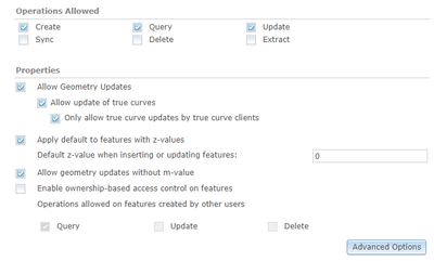

I'd like to add that for our organization, we like to restrict field edits to updating a few selected fields and adding/deleting attachments. We didn't allow field users to add or delete features or update geometries with our Geometric Network data, and we were able to publish services that let us lock things down this way. The Utility Network currently requires all editing options be turned on when you publish.
LoriRadunzel-Davis
JC - You can set the services to limit users options.  In Server Manager click on the service and go to Capabilities - Feature Access.
You can then check or uncheck the ones you want.
