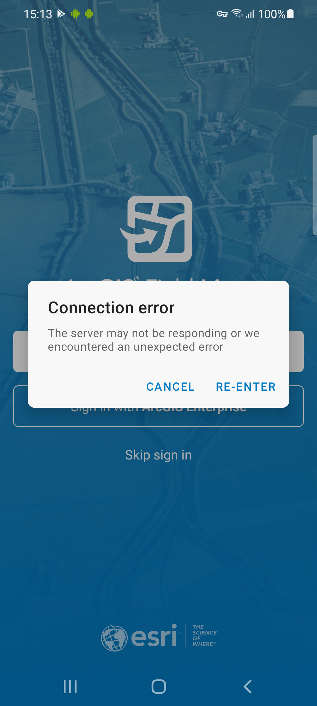

Hi Field Maps Users,
We are having issues using Field Maps on Android devices to connect to our Portal.
  • Enterprise 10.7.1 installation
  • Portal is configured with Windows Active Directory as the identity store
  • Field Maps App ID is registered in our Portal
Error message on Android devices after entering our Enterprise URL.
  • "Connection error - The server may not be responding or we encountered an unexpected error"
We can connect using our Portal URL in Chrome and other browsers on Android without issues. No certificate errors given. We have tried manually installing certificates on devices and it doesn't make a difference.
Field Maps successfully connects to our Portal on iOS devices. iOS prompts for credentials and allows log in.
Anyone have suggestions for how to address this on Android?
Thanks!

Something Esri support had us try recently was adding "//" to the end of our Portal URL.
We've had some success using this format with Field Maps on Android devices as a workaround to this error.
Hopefully this works for others as well.
