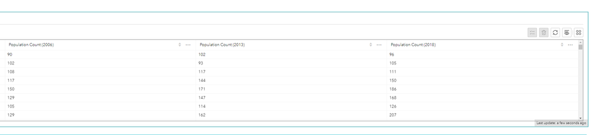

Is it possible to for the table widget to only export the shown fields in the table rather than all the fields in the layer? I know this is possible for Dashboard widgets so some similar functionality would be super useful.
For example, I only have a few fields selected for this table:
However when I export the table, it gives me the entire spreadsheet with the raw data and even fields I had hidden in ArcPro.
Is there a way to configure this in ExB without having to reconfigure all my layers?

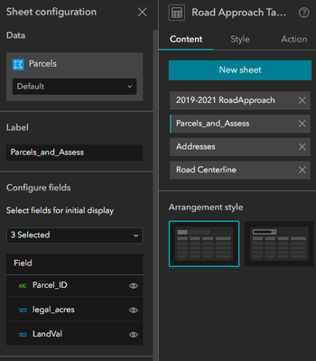

I found a work around, hopefully this helps. From Experience builder you will need to click on the table and configure the fields once you have the selected fields that you want exported you'll need to follow the steps below.

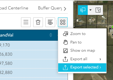

  1. Select the select icon and highlight the data.
  2. From your table you’ll select the four-circle icon and export selected. You'll know you configured your table correctly when you only see the fields chosen within the table widget.

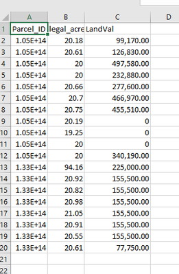

3. The results should look like this –

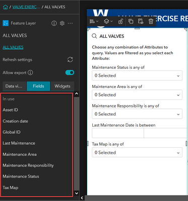

@Jianxiaare you aware this issues exists for other widgets that allow tabular exports such as the Query widget? At Exb v11.1 despite my fields being specified I get them all...
Cross posted here also
