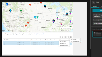

Hey guys, it seems like the issue has been fixed. This is what I saw from my experience.

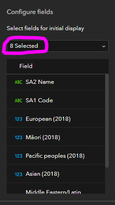

The fields in the table (only 8):

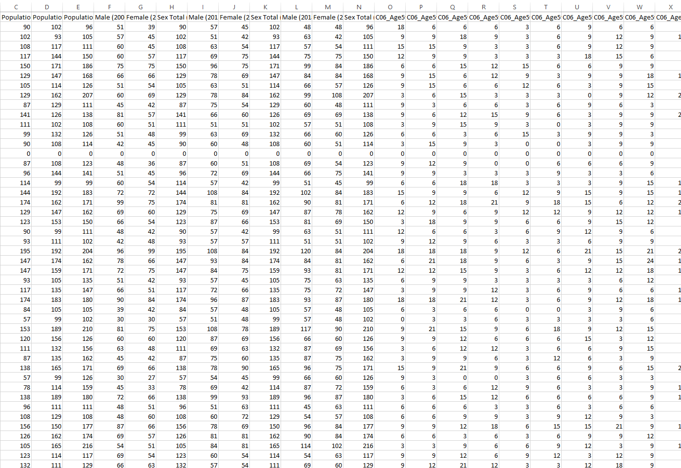

The export (shows all other fields in the layer):
