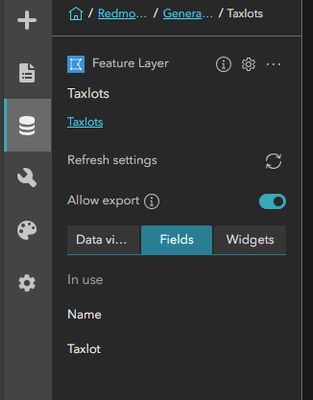

We have built an Experience Builder app on ArcGIS Online. We are wanting users to be able to select taxlots and export out that data to a csv. The issue we are having is the fields that are included. Right now the only fields that are exporting are the object id, name and taxlot #. The layer has a popup configured that includes 10 fields, but I'm not able to get those to be included from the Select widget export. If I export from the Map Layers widget all the fields are included, but it does not respect the selection.
I see a note in the Select widget settings that states that "Export is configured in the Data panel." I navigate to the data panel, choose the Taxlots layer and click on Fields, and it shows me the information below. I cannot find a way to configure this.
Am I missing a configuration somewhere that will allow me to modify the fields included when I export from the Select widget?

This seems like a bug to me.  The Select widget seems to only exports fields being used by other widgets (list of fields shown in your screenshot).  If you have a Table widget in your map, one work around is to send the selection to table and then export the CSV from the table.  This adds an extra step for end-users unfortunately.
Another possible workaround is to configure a table widget hidden somewhere inaccessible to end-users and configure the layers in the table so the correct fields are "In use", and then the Select widget exports appropriately.
Neither solution is great.  Hopefully they can get this widget fixed soon because it has been a great addition otherwise.
GISHelp
Yes, we ended up discovering this intentional "feature" (Esri insists this is not a bug) when we were able to talk to Esri. We ended up adding an attribute table widget and then "marked as pending" so it was not visible to the end user, but all the fields were able to be selected for export. You are right - an extra step for app designers, and it has not been explicitly stated in any of the documentation that this "feature" exists.

Thanks for your feedback. As Marshal found, widget could only export fields being used by other widgets.
This is expected now. Because if one layer with lots of fields, all the fields are loading in the app, it will affect the performance of the app.

After the February 2025 update, the Select widget and Feature Info widgets load pop-up fields in data actions. It will export the fields used in Popup. And it will be released on the upcoming Portal 11.5.
Thanks,
