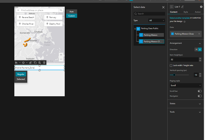

FranciscoRodriguez2
Hi David,
I was looking for the same functionality and came across this post. I cant for the life of me find the ENABLE MAXIMUM ITEMS FOR 1.  On the contents panel for the list widget.  Any help would be greatly appreciated.
DavidMartinez
Hi Francisco,
I just noticed the other day that option has been removed. Can you explain your workflow to me?
Thanks,
David

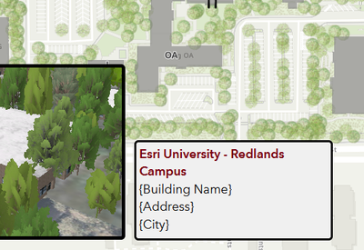

BrianBaldwin
Just providing a 'bump' on the ability to hide the expressions when nothing is selected, or meets the criteria:
This presents a pretty goofy looking solution to the end user...
I could also put multiple features into the same text box... so that if only one feature is selected, then those details populate in the text box.
